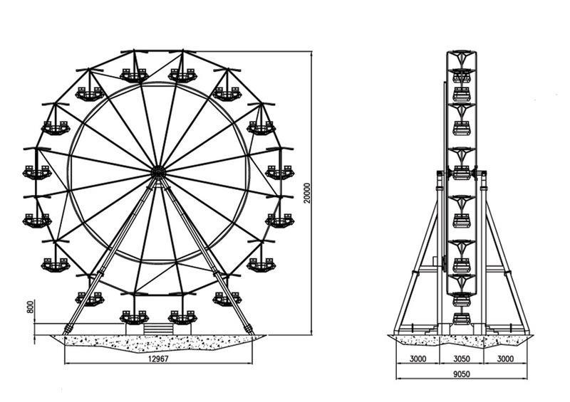

It is reasonable to assume that the wheels are adjacent, as shown in the figure. D=10.63 m, the launch happens at 2.50 m height, so the apex of the 18 m height wheels are H=15.5 m above the launch position.
The human cannon ball is launched at Vo velocity, with x component Vx and y component Vy. You have to find the minimal Vo which ensures that the ball is at height H above the first and last wheels.
The ball moves along a parabola, and the highest point above the middle wheel is Ymax= Vy2/2g.
Consider the time instant when the ball is at the apex of the parabola, above the middle wheel. The horizontal velocity component is constant during the flight. It reaches the last wheel in time Δt=D/Vx. Its height changes from Ymax to H, and the vertical velocity component becomes gΔt. Write up conservation of energy: You get an equation for Vy in terms of Vx. To ensure minimum Vo, the derivative of Vx2+Vy2 has to be zero.
The text of the problem can be understood that the human cannon ball has to fly over the distance spanned by the three wheels. In this case, the ball was fired at the edge of the first wheel, D/2 distance from the apex, at height of 2.5 m. Using the equation of the trajectory, Vx and Vy has to be found which correspond y=15.5 m at both x1=D/2 and x2=5D/2.

Yes, you can try and see when you get the minimum vo. But the problem has an exact solution.
The geometry of the problem is not clearly stated. One can understand that the three wheels altogether cover 10.63 m distance, or each of them does.
a human cannonball in 1940 soared over three ferris wheels, each 18 meters high covering a horizontal distance of 10.63 meters. Assuming that the point of projection is 2.50 meters above the ground and that he landed safely on a net placed at the same level, find his initial velocity.
Looking at the picture of a Ferris Wheel, I am inclined to believe the second geometry is valid.
