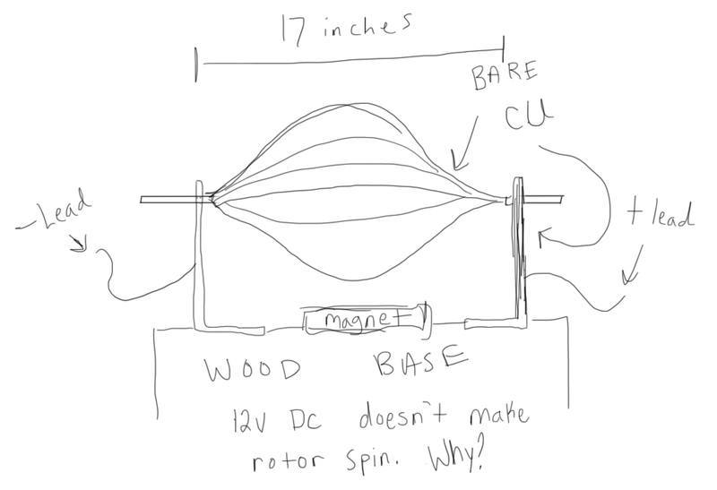

A picture I included shows how my motor is constructed. The basic science fair project looking engine. This engine is actually designed to do work, however, it will not turn over once DC is connected to it.
The wire is close to 5/64 inch thick and the whole rotor is solidly soldered together. I had a heck of a time finding Magnets for the thing and finally found a circle magnet form a CB radio antenna. I was able to see some movement when 4 C cells were used as power, but no rotation was able to be achieved.
What have I done wrong folks? Thanks for you're help if you help me ;)

You need to be able to continuously switch the current direction; coil attracted to magnet then repelled from magnet. This is accomplished on dc motors by using Commutator and Brushes.

I am confused because the construction of my motor is just like the smaller ones. I have jumped up the volts, and jumped up the magnet. I am just curious as to why it doesn't work.
There must be some reason?
Check out the picture on the first post.

Your design is also not good one. Using Coils would allow you to have much more torque by flowing little current. Also wire melting problem can be mitigated because, the long length of wire will reduce current flow.

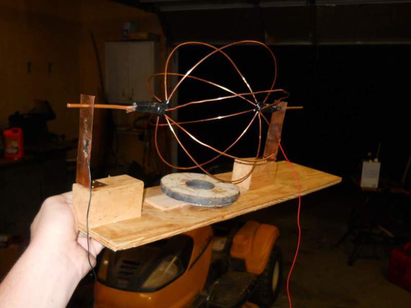

Here is a picture of the motor. I chose this design because it shows the beauty of movement! All of the other designs are small and compact which don't interest me.
Everything on the rotor is SOLDERED together. The tape is just to protect my hands form the pointy protrusions

See the basic thoery
F ~= B*N*I*L
In your case no. of turns N = 1.
Lots of design use at-least N = 15-20.
So, you need to compensated your N=1 by increasing I by 15-20 times, provided you use magnet (B) of same capacity. You seem to be using alnico magnet, which isn't as powerful as neodymium magnets.
The wires seem very sturdy, I don't think it melts with 8-10A. How long did you let it on?
The only thing you could do is increase the current even more.
But you need to make really sure that the support is friction free and the thing can rotate even with slight force.
Once again, design change is what I suggest. You could easily scale up the 'compact' design.

a number of problems some of which I_am_learning referred to
one other is the magnet ... not what the manget if made of .... ''You seem to be using alnico magnet, which isn't as powerful as neodymium magnets.'' that I_am_learning also commented on, thats of least importance and your problems.
The big problem is the shape of the magnet and its orientation to the coil. You cannot use a single magnet in the way you have shown
Look closely at the drawing that dlgoff showed in his post above and particularly note that the coil sits BETWEEN the N and S poles of the magnet
The single turn of wire as you have will not work .... although you may think you have multiple turns, you dont they are just single strips of wire in parallel with each other.
You need an actual coil of wire with multiple turns that starts at one side of the upright and goes through to the other side/upright
You will be able to make it work that way which is a variation on that drawing that has bother end of the wire coil coming out the same side

Could I wrap the entire thing in copper wire? Make it look somewhat of a sphere?
I have a feeling that the wires are heating up because I do not have these coils of wire that you suggest. The multimeter does show low resistance.......
I have made smaller models that have worked. They looked just like this. Although they had about 1-3 turns of wire.
Will try to improve it.

Found magnetic wire in an old treadmill. Made a large 7 wind circle and got it to barely wiggle when 6vDC was applied.
I think it is my magnet....

I proved today that a single wind of magnetic wire works. I was able to make a small 3 inch diameter circle out of mag. wire and make it rotate with 9v and the same support setup as the larger motor .
The culprit in my experiment is my magnet. I notice that speaker magnets don't have a wide spread field like this little doughnut magnet I have.
Tried hooking up the "eggbeater" to a 12v supply and it melted the wires. With magnetic wire I notice that it is non conductive with the coating on it, so sanding it made the smaller rotor possible to rotate. It did not rotate on its own, I had to get it started.
Is there a formula I can use to determine the strength of a magnet that I need to get this " Eggbeater" to work.
I know it is possible. It has to be.
