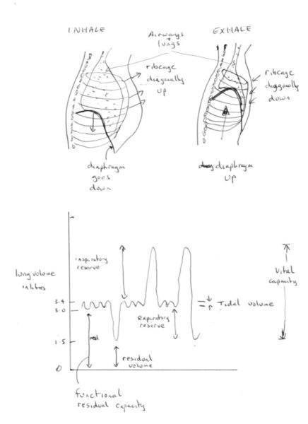

To aid the purpose of discussion here are some rather hasty sketches of the breathing process and a typical output from a spirometer.
As you can see breathing is an asymmetric process.
Since muscles can onlly pull not push, body muscles work in antagonistic pairs, each pulling the opposite way.
For breathing the antagonistic pairs are the internal and external intercostal muscles.
To inhale the external ic muscles contract and the internal ic muscles relax, forcing the ribcage up and out. At the same time the diaphragm moves down.
This expands the thorax volume and since the lungs are fixed to the diaphragm and ribcage they are expanded with it, thus lowering their internal pressure. Outside air is then at a higher pressure and flows into the expanded space.
To exhale the external ic muscles relax and the diaphragm relaxes.
Note the internal ic muscles are still relaxed at this stage.
This is enough to return the thorax and lungs to its previous volume, compressing the air in the lungs (raising its pressure) to above extenal so air flow out.
this process produces the tidal volume ripple in the spirometer graph below.
Further forced exhalation is possible by then contracting the internal ic muscles to take up the expiratory reserve volume.
The lungs are never fully emptied, always maintaining a residual volume.
