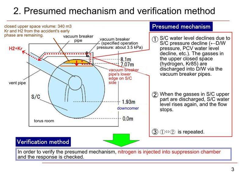

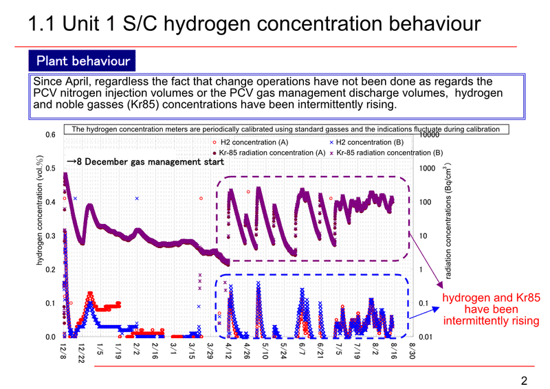

tsutsuji said:

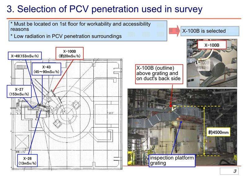

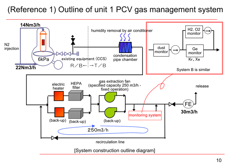

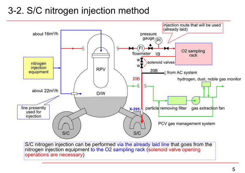

27 August 2012 government-Tokyo Electric mid and long term response committee, steering committee (9th meeting)
3-1 Cooling by closed loop water injection
http://www.meti.go.jp/earthquake/nuclear/pdf/120827/120827_01j.pdf Nitrogen injection into unit 1's suppression chamber
2) Translation:
01/11
02/11
03/11

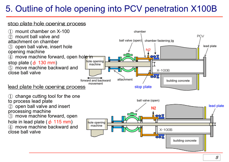

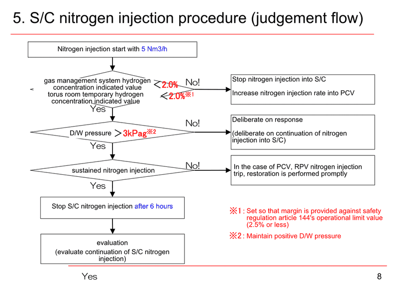

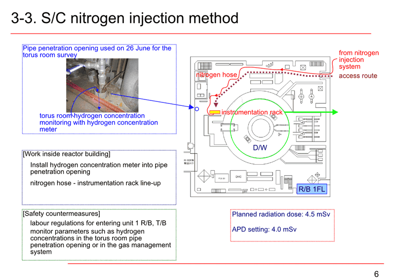

2) Translation:
04/11
05/11
06/11

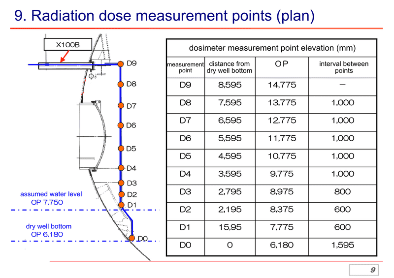

2) Translation:
07/11
08/11
09/11

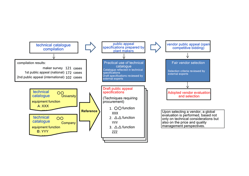

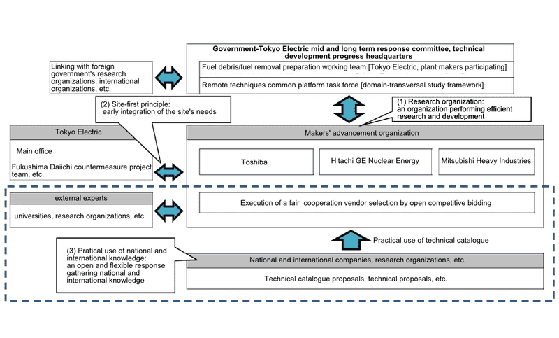

Thanks everybody for the encouraging comments. I have started translating http://www.meti.go.jp/earthquake/nuclear/pdf/120827/120827_02c.pdf "Progress status of development of machinery and equipments to prepare fuel debris removal" which will give a glimpse of the research & development planned by Toshiba/Hitachi/Mitsubishi over the longer term. But this will take me quite some time as these are 34 pages, some of which are rather dense.
The first diagram:

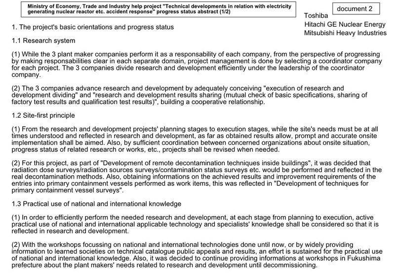

27 August 2012 government-Tokyo Electric mid and long term response committee, technical development progress headquarters (8th meeting) ( http://www.meti.go.jp/earthquake/nuclear/20120827_02.html )
Document 2
http://www.meti.go.jp/earthquake/nuclear/pdf/120827/120827_02c.pdf Progress status of development of machinery and equipments to prepare fuel debris removal
1) Previous related topics:
http://www.tepco.co.jp/en/press/corp-com/release/betu11_e/images/111221e14.pdf (English) p. 54/94-94/94: "Research and Development Road Map for Decommissioning Units 1~4 at TEPCO's Fukushima Daiichi Nuclear Power Plant" (1st meeting of the Government-TEPCO Mid-and-long Term Response Council, 21 December 2011)
2) Translation: [installment 1: abstract]
01/34 (1/4)
01/34 (2/4)

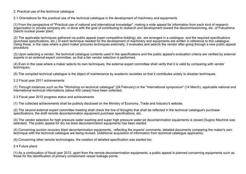

02/34 (1/3)
02/34 (2/3)
02/34 (3/3)

Translation [installment 2: remote decontamination]
05/34
06/34
07/34

mscharisma said:
And so here's my new question: with so many unknowns and variables, is the real message/news here not that temperatures are rising for uncertain reasons and we're all guessing why, likely including TEPCO?
In some ways you could say that about many aspects of the disaster since day one. Thats why far more speculation has been allowed on the Fukushima topic than would normally be tolerated on a forum that holds the values of science dear.
But even at worst its still fairly educated guessing, often supported by more than one kind of observation or test.
In the case of these temperature changes its not hard for TEPCO etc to compare the ambient temperature, amount of sunlight and other weather issues with flow rates and the history of temperatures at the reactors, and to work out whether what is happening is within the bounds explained by seasonal variations. And let's not forget that the actual temperature increases have really not been anywhere close to substantial enough to warrant much exploration of alternative hypothesise.
And as for the flow rates, the drops in water injection rates seen since late August were certainly substantial enough for them to investigate. It now seems likely that a change of pipework at that time lead to foreign objects in the buffer tank, in this case plastic shavings:
http://www.tepco.co.jp/en/nu/fukushima-np/images/handouts_120911_02-e.pdf

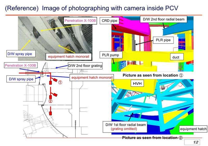

Translation [installment 3: PCV leakage points identification]
09/34 1/2
09/34 2/2
10/34

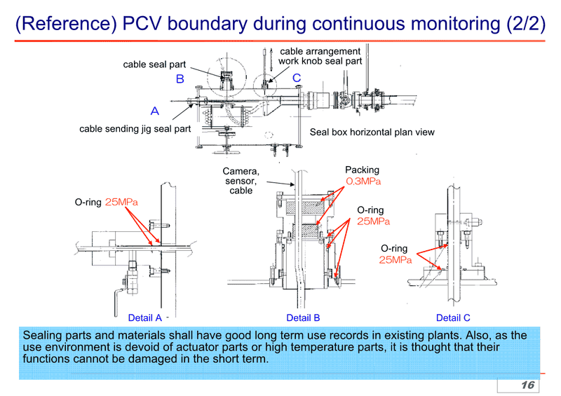

11/34 1/2
11/34 2/2
12/34
