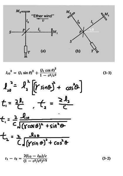

1. The problem statement, all variables and given/known data
Due to the ether wind, anything that moves along it is "contracted".
3. The attempt at a solution
Taking L1 to be contracted length,
(L1)2
= (L1x)2 + (L1Y)2
= (L10,X/γ)2 + (L10,Y)2
But what they wrote is the opposite..

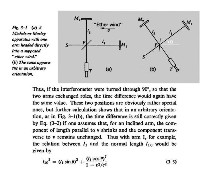

The equation (3-3) in the book is an expression for the "normal" (not contracted) length in terms of the components of the contracted length. Your expression is for the contracted length in terms of the components of the normal length.
Apparently rotating the setup at an angle doesn't change the time difference between t1 and t2..
But the square roots below are clearly different..

Note that the time, [itex]t_1[/itex], to travel out and back along [itex]l_1[/itex] is not [itex]2l_1/c[/itex] because ##c## is not the speed of light relative to the apparatus. You're going to have to figure out the speed of the light relative to the apparatus for the light going out along arm [itex]l_1[/itex] and the (different) speed for the light coming back. Likewise for the other arm.

I assume:
1) only the component parallel to ether wind is affected by it
2) The light is aimed at a smaller angle to compensate for this
so the speed towards is:
√[ (c sinθ)2 + (c cosθ - v)2 ]
and the speed back is:
√[ (c sinθ)2 + (c cosθ + v)2 ]
Not sure if that's right..

That would be ok if θ here is the angle that the light is "aimed at". But in that case, it's not the angle of inclination of the arm as shown in the diagram.

I'm not sure what you mean..If c is indeed affected by ether wind won't θ be off-balanced?

Indeed. You'll have to fire the light beam in some direction [itex]\phi[/itex] so that the wind will blow it into the direction θ (along the arm). I was interpreting the direction "aimed at" as the direction fired ([itex]\phi[/itex]). Your expression for the light speed relative to the apparatus is ok if your θ is replaced by [itex]\phi[/itex].
You might try drawing a velocity addition triangle and using the law of cosines to express the light speed relative to the apparatus in terms of θ without worrying about the value of [itex]\phi[/itex].

Can't seem to get it to be independent of ∅... it turns out as (θ-∅)
