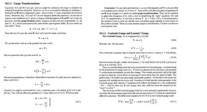

My book has introduced the idea of gauge invariance in terms of classical electrodynamics (attached file). However, I am not sure I completely understand how it works. On the one hand they use a lot of time on specifying how you can add to the vector potential the gradient of any scalar, whilst at the same time subtracting the time derivative of this scalar from the generalized electrical potential. On the other hand when it comes to the use of this property, as in the section "The coloumb Gauge" they just PICK the divergence of A to be zero. I know that is always possible but shouldn't V be adjusted at the same time? I think I'm getting something wrong. I don't think I understand what the original potentials always are... Because gauge transformations speaks of adjusting these, but can you really say that there are original potentials?

The point of gauge invariance in classical electromagnetics is that you can choose the scalar and vector potential (more appropriate is to say you have one four-vector potential in the sense of special relativity, but unfortunately most textbooks first start with the old-fashioned 1+3-dimensional formalism, so I also use this formalism) with some arbitrariness. Physically meaningful, i.e., measurable quantities are the electric and magnetic components of the electromagnetic field, which are related to the potentials (using Heaviside Lorentz units) via
[tex]\vec{E}=-\frac{1}{c} \frac{\partial \vec{A}}{\partial t}-\vec{\nabla} \Phi, \quad \vec{B}=\vec{\nabla} \times \vec{A}.[/tex]
This ansatz solves the two homogeneous Maxwell equations, and vice versa these Maxwell equations also guarantee the existence of such potentials:
[tex]\vec{\nabla} \cdot \vec{B}=0, \quad \frac{1}{c} \frac{\partial \vec{B}}{\partial t}+\vec{\nabla} \times \vec{E}=0.[/tex]
Any other set of potentials, given by
[tex]\Phi'=\Phi+\frac{1}{c} \partial \chi, \quad \vec{A}'=\vec{a}-\vec{\nabla} \chi[/tex]
obviously gives the same em. field [itex](\vec{E},\vec{B})[/itex], no matter which scalar field [itex]\chi[/itex] you take.
Now, usually the task is to solve Maxwell's equations for given charge and current distributions and maybe subject to some boundary conditions. This task can be made much easier by "choosing the gauge" appropriately. This is done by imposing one constraint on the potentials. For dynamical problems most convenient is the Lorenz gauge (sometimes still called Lorentz gauge, which is a bit unjust against Lorenz, who found this gauge way earlier than Lorentz)
[tex]\frac{1}{c} \frac{\partial \Phi}{\partial t}+\vec{\nabla} \cdot \vec{A}=0.[/tex]
Particularly in static or stationary problems the Coulomb gauge is most convenient:
[tex]\vec{\nabla} \cdot \vec{A}=0.[/tex]
There is in principle no way to say the one or the other gauge is more natural than the other.

Of course, the resulting equations change with the choice of gauge, depending on the chosen gauge condition, and this adapts both the vector and the scalar potential to this choice. For the Lorenz gauge the gauge condition leads to
[tex]\left (\frac{1}{c^2} \partial_t^2-\Delta \right ) \Phi=\rho, \quad \left (\frac{1}{c^2} \partial_t^2-\Delta \right ) \vec{A}=\vec{j}.[/tex]
You should figure out, how the equations look in the Coulomb gauge.

But if you have already picked a gauge, say the coloumb gauge where you specify A, how do you then know that the potential in the equations is exactly the one that goes well with this A? I guess it should follow directly from how you defined gauge symmetry, but I'm still a bit confused whether it does or whether you should also define a potential that goes well with your A.

The integrability conditions are of course on the currents, i.e., the four-current must be conserved. In 3D notation that means the continuity equation
[tex]\frac{\partial{\rho}}{\partial t}+\vec{\nabla} \cdot \vec{j}=0[/tex]
must hold true. Otherwise you violate gauge invariance of electromagnetism, and you get a contradiction with the gauge condition after solving the equations.
Let's look at the Coulomb gauge. In this case the inhomogeneous Maxwell equations translate into (again in Heaviside-Lorentz units, see my first posting in this thread)
[tex]\Delta \Phi=-\rho, \quad \Box \vec{A}=\frac{1}{c} \left (\vec{J}-\frac{\partial \vec{\nabla} \Phi}{\partial t} \right )=:\frac{1}{c} \vec{J}_{\perp}.[/tex]
