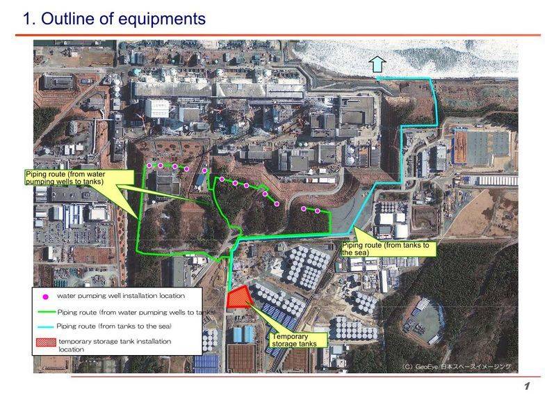

Quote by tsutsuji View Post

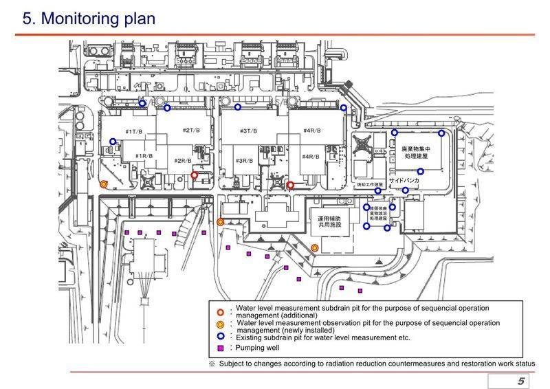

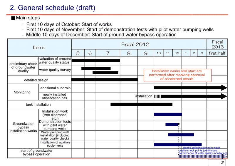

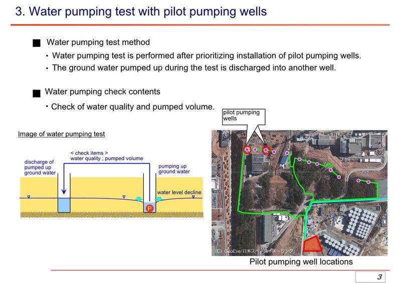

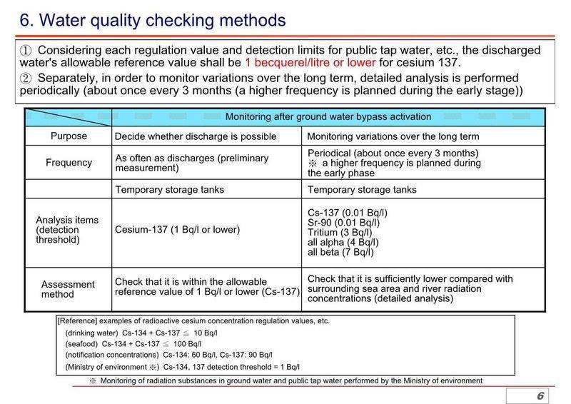

24 September 2012 government-Tokyo Electric mid and long term response committee, steering committee (10th meeting)
3-2 Treatment of accumulated water
http://www.meti.go.jp/earthquake/nuc...120924_01n.pdf Ground water bypass action plan
1) Previous related topics:
http://www.physicsforums.com/showthr...36#post3882136 23 April 2012 Plan to reduce volumes of groundwater seeping into units 1~4 buildings by groundwater bypass
http://www.tepco.co.jp/en/nu/fukushi...20618_05-e.pdf 18 June 2012 Progress status of ground water bypass
2) Translation:
As pages 08/11 to 11/11 happen to be copies of older presentation, I translate only the new materials found on pages 01-07 :
01/11

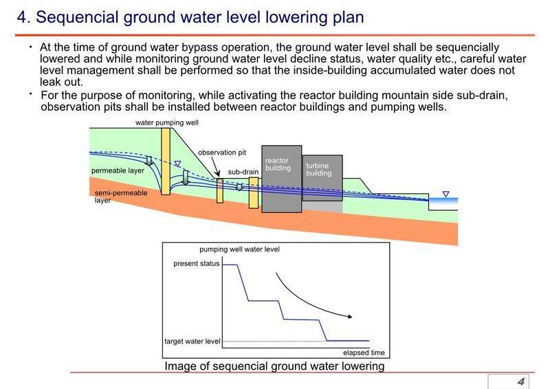

2) Translation:
02/11
03/11
04/11
Groundwater bypass 02of11.jpg   Groundwater bypass 03of11.png   Groundwater bypass 04of11.jpg

2) Translation:
05/11
06/11
07/11

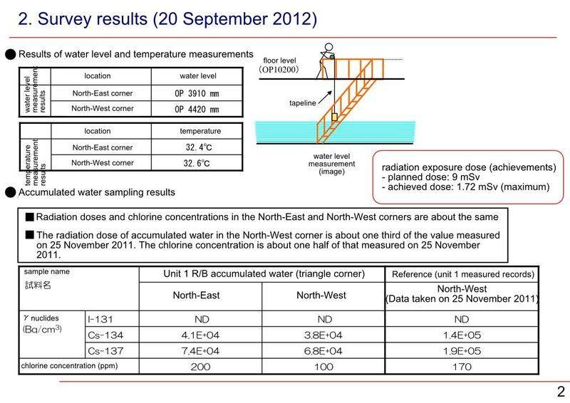

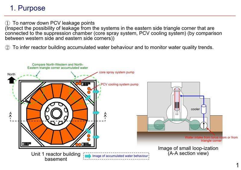

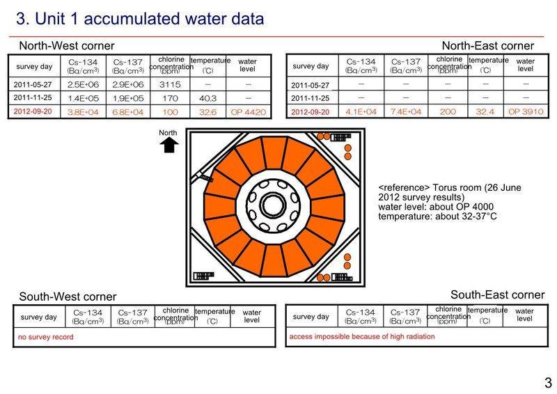

3-6 Preparations for fuel debris removal
http://www.meti.go.jp/earthquake/nuc...20924_01ee.pdf Survey of accumulated water inside unit 1 reactor building triangle corners
Translation:
01/06
02/06
03/06
Unit 1 triangle corner water 2of6.jpg   Unit 1 triangle corner water 3of6.jpg   Unit 1 triangle corner water 1of6.jpg

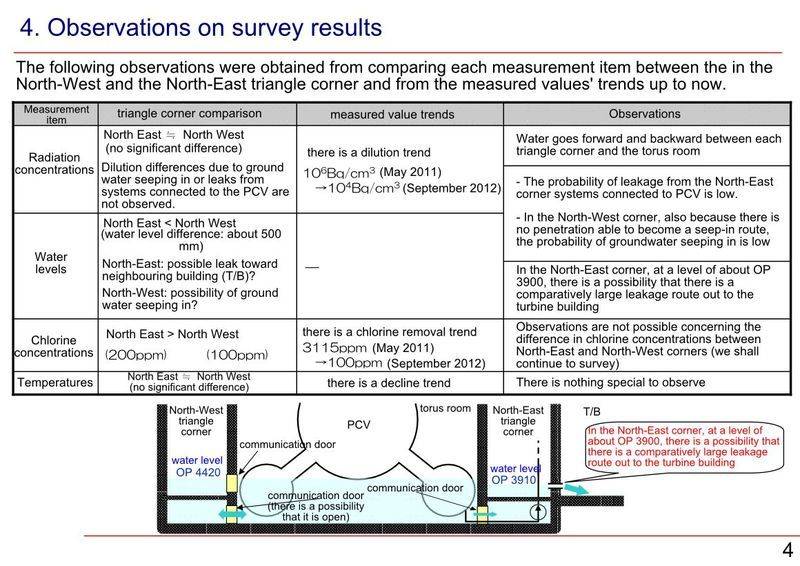

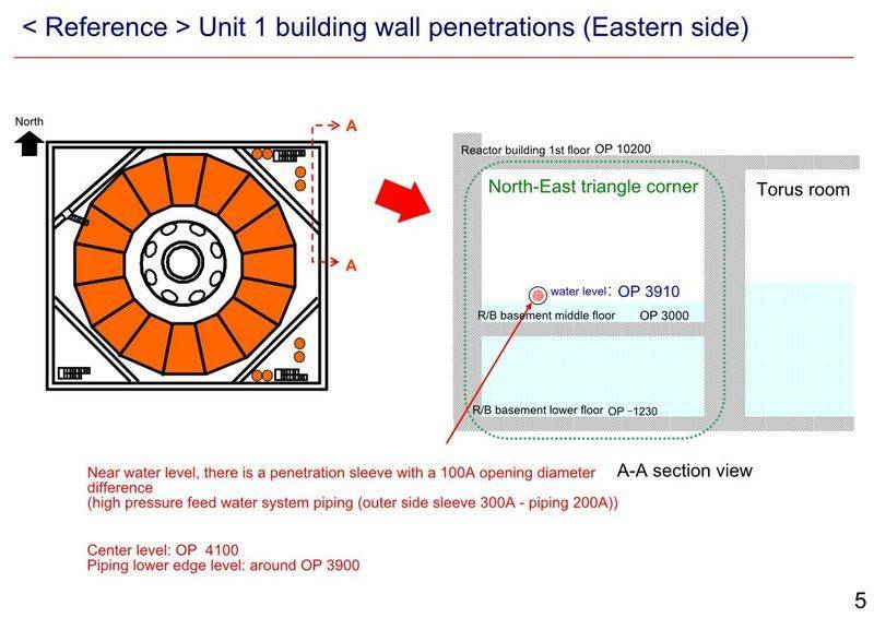

Translation:
04/06
05/06
06/06
Unit 1 triangle corner water 4of6.jpg   Unit 1 triangle corner water 5of6.jpg   Unit 1 triangle corner water 6of6.jpg

So the idea, if I understand it right, is to lower the local water table level to that of the water inside the reactors?
Oct16-12, 07:05 AM   #13766
Quote by zapperzero View Post
The idea is to enable lowering the water level inside the buildings (and ultimately to pump them dry) without causing an increase in the groundwater inflow.
Oct16-12, 07:11 AM   #13767
Quote by rmattila View Post
So they are meant to keep the inflow?
Oct16-12, 08:13 AM   #13768
Have you guys seen this?
http://www.tepco.co.jp/en/nu/fukushi...21015_01-e.pdf
One of the pictures shows what appears to be part of an empty rack.
Oct16-12, 02:09 PM   #13769
Quote by Rive View Post
You want just enough inflow so you know contaminants are not flowing out. But not so much inflow that your pumps cant keep up.
