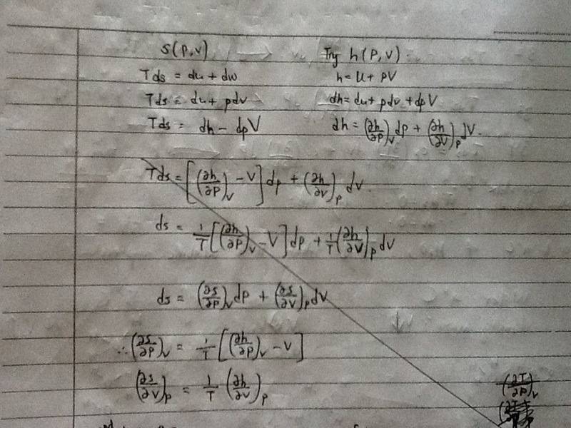

I am not really understand what is Maxwell ,

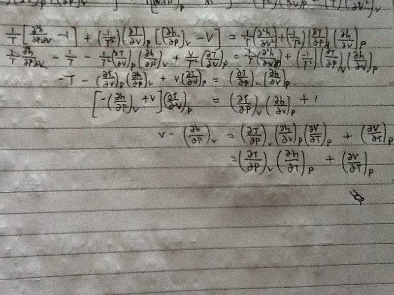

I only can get (∂s/∂P) at constant volume = (1/T)(∂h/∂P)constant volume -(v/T)
Please post your working to get that.
Trial
This first , only that second deriavative
You need to follow BiP's advice and familurize yourself with the derivation and application of the Maxwell equations.
