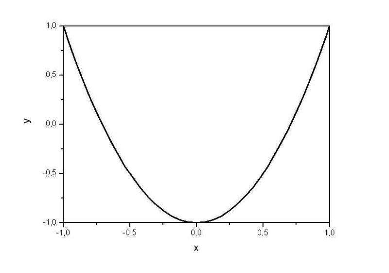

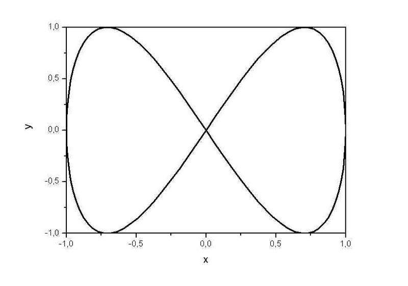

Your first attempt was
x=a cosωt
y=a sin(2ωt+π/2) which is equivalent to
y=a cos (2ωt)I do not see any initial phase difference between x and y.
Your second attempt is true and so is the third one. Phase difference between x and y is not a clear concept. You get x,y curves of different form if x=sin(ωt), y=cos(2ωt) (y=1-2x2) and when x=cos(ωt) and y=sin(2ωt) (y2=4x2(1-x2))
ehild
