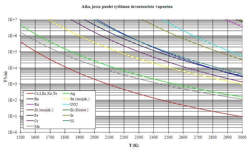

For this reason i would like to better understand how much radioactive material can get from the fuel into containment atmosphere and ultimately the environment at later stages, compared to the amount that can be generated and released during the initial melt. This is one way to better understand how much the failure to take into account later events may have distorted the picture that reactor 2 was responsible for the bulk of the environmental release.
In the attached picture there are half-times of different elements in the fuel matrix. For I, Xe, Cs and Te, the half-time at melting temperature is only 10 s, i.e. when the fuel reaches melting point, these substances are already out of the fuel matrix and in the containment.

Thanks :)

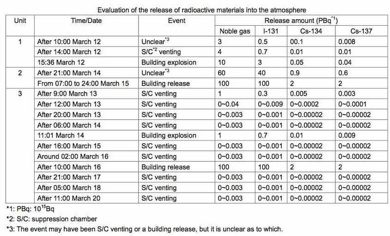

Page 368 from this TEPCO document shows release estimates for different events. They have very high amounts from reactor 3 on March 16th, the same values as for reactor 2 on March 15th! Reactor 2 still 'wins' because there are also notable releases after 21:00 on March 14th, but even so I think this data will be of interest to people.
These figures are hardly likely to be perfect, to pick one example they miss out any releases from reactor 1 after the building explosions, whereas some non-TEPCO reports I talked about recently mention the possibility of this.
http://www.tepco.co.jp/en/press/corp...20620e0104.pdf
