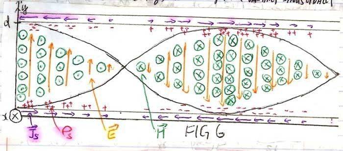

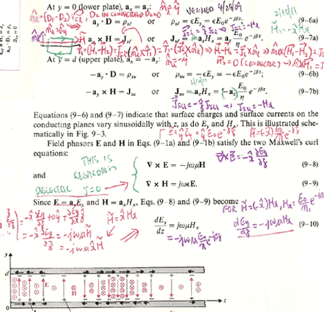

Which part you don't get that the OP was asking about the tangential H field and current in question 3? That EM wave produce current by boundary condition?
Read Field and Wave Electromagnetics by David K Cheng page 262 that clearly state the tangential H field create surface current. AND page 331 to 332 CLEARLY explains FREE current density created at the boundary between dielectric and good conductor in equation 7-70.
[tex] \hat A_{n2}\;\times\;(\vec H_1-\vec H_2)= \vec J_s [/tex]
Then in page 430 and 431. It explain the boundary condition creates SURFACE CURRENT on the conductor plates of the parallel plate tx line.
[tex]\hat a_y \;\times\; \vec H=\vec J_{su}\;[/tex]
See the attached image of p430 below. If you don't think the boundary condition produce surface current, why are you saying K in your equation is surface current? Your equation is almost exactly the same as I quoted from the book. Are you confused?

Attached is an image of page 430. It is blur as I have to shrink the size to 300K. The equation in question is 9-7b for the upper plate. Ignore all my hand written notes, just read the text of the book. The second image is my drawing according to the figure from the book, I added color and more detail. The figure at the bottom of the text page is Fig.9-3 if you care to read the text.
[tex] -\hat a_y\times \vec H=\vec J_{su}[/tex]
