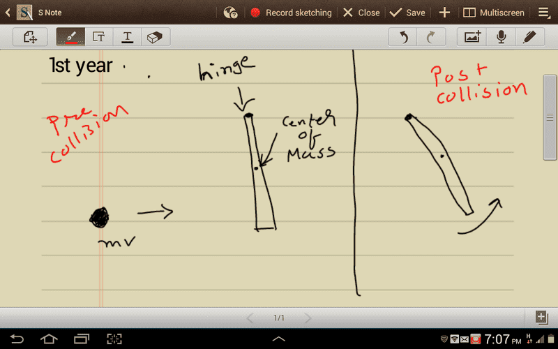

Dec23-12, 07:45 AM   #5
Plz see the screenshot attached. How did linear momentum of the ball converted into angular momentum of the rotating road. I hope I've clarified my question.

Dec23-12, 08:47 AM   #6
Mentor
Blog Entries: 1
Quote by kavan View Post
Even before the collision, the ball has angular momentum about the hinge. Angular momentum is conserved during the collision. (Linear momentum is not. As already pointed out, you cannot ignore the force of the hinge on the door.)

Dec24-12, 05:04 AM   #8
As for converting linear to angular momentum you have to know that everything that has linear momentum has angular momentum too and the other way round.
When it comes to the collision the energy of the ball is given to the door as momentum. The only motion that the door can perform is a rotation and therefore all of the energy goes in it. During the rotation the door's linear momentum is conserved within the system door-hinge. The angular momentum is conserved for itself in the rotation.
When you calculate it you will see that the angular momentum of the ball in relation to a random point is the same as the angular momentum of the door related to the same point.
The linear momentum of the rotating door cannot be described so well using Newtonian mechanics. Instead you need the term of constraints since the hinge is a constraint for the door.
