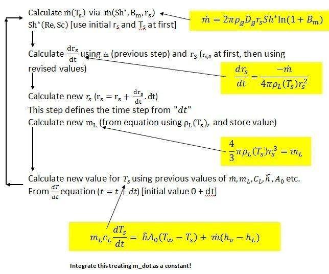

Thank you for your response! I really appreciate it. I am getting really into this work (it's for an important project) but as it is the holidays I cannot ask for assistance from my supervisor.
I have attached an image of the process I think is correct. I would really appreciate it if you could have a look at it for me. I have a few questions regarding the process. My equations are included in the attached image.
Am I correct in saying m_dot is a function of T_s (m_dot(T_s))? Evaluating values at T_s,0 (initial surface temperature), and then using revised values on each loop? I have trouble evaluating B_m in this case too, but I understand the principle.
Revising the value of r_s makes sense to me, I think that part is correct?
Calculating the new value of T_s is where my major problem lies. Can I take m_dot to be constant here, i.e use the value obtained in the first step in the attached image, and then integrate the whole thing and use whatever value of t I am on (t = t + dt)? I would then use this new value of T_s (to revise the values of Re, Sc, Y_Fs etc.) along with new r_s to get a new m_dot and repeat the cycle.
Many thanks!

This should work, although it is not exactly how I would have done it. You can simplify things a little by writing
dm/dt = -m_dot, and integrating to get m. Then after taking a time step, calculate the new value of rs from the new value of m. Also, as I said earlier, the effect of temperature on density is not going to be important in this problem.
Work the equations into a form so that you have two coupled simultaneous first order ordinary differential equations:
dT/dt = A (m,T)
and
dm/dt = B (m,T)
The rest of the equations are algebraic, and can be used to establish the values of A(m,T) and B(m,T). The numerical method of solution you proposed is Forward Euler, and gives accurate results if dt is sufficiently small. Runge Kutta is another possibility, and can use larger values of dt. There are also automatic equation solver packages available (for free) that solve sets of coupled simultaneous first order ordinary differential equations using techniques that automatically control error tolerance. I like these quite a bit, and almost always use them. The IMSL library has a package that should suit you needs.

What you have is perfectly OK. m is the same as ml.
Before you calculate the derivatives, you might consider first calculating m_dot and also r. Then your equation for dml/dt
is
dml/dt = -m_dot
Then you calculate dTl/dt
The next step is to take a time step in both dependent variables, say using forward Euler. Then loop back to the beginning.
