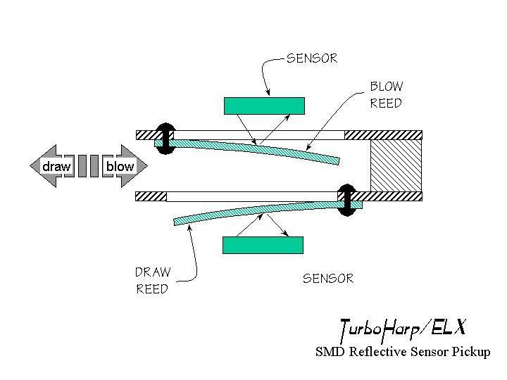

The signal I am transducing is surprisingly enough, a harmonica reed. Actually a set of ten reeds, summed. The noise appears to intensify with each additional sensor, rather than canelling out :-( But I'm intrigued by the idea of signal averaging... which I would know how to accomplish if it were a digital signal but cannot imagine how to do without some sort of sample/hold.
I'm relatively sure of the noise source as I experimented with a single isolated sensor with just a pull up resistor, illuminated by mini incandescent lamp. Completely sikent until the lamp is powered up.

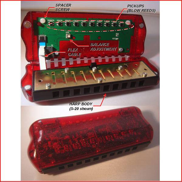

Regarding the illumination setup, I've attached a photo and diagram to illustrate the arrangement. The reeds are relatively reflective, made of polished brass/bronze.
I apologize for the yellow hilighting in the datasheet. I didnt realize that it made the text illegible. Attached is a clean version. The typical value of Ic is at the bottom of page 3. It refers to the "on state" inasmuch as the sensor was most probably intended for on/off binary detection of a target rather than the linear application I am forcing out of it.

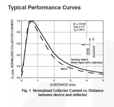

Your recommendations concerning the intensity of illumination is, unfortunately, inconsistent with my observations. I found that the intensity of the noise is monotonically related to the intensity of the light (both when I use the built-in IR LED, or an independent grain-of-wheat incandescent.) The signal, on the other hand is unimodal. No kidding. The amplitude of the signal increases with LED current up to a point, but then drop off precipitously. If I move the target farther away from the sensor, then the point at which this drop occurs moves to a higher level of current. But still the same behavior is exhibited.

I now see the physical layout and it's obviously fairly cramped in there! Looking at the way you have mounted the sensors. I have some relevant points to make, the way the angle of the reed affects the illumination of the photo transistor could be increased significantly. The light flux hitting the sensor will hardly be affected by the distance from the reed in its motion - it will be due to the changing angle of the reed deflecting light away from the sensor to a varying degree. I think, if you had the sensor units rotated 90 degrees from their present orientation. Also, if the sensor were positioned at the end of the reed, the variation of angle would be at least double what you could expect if it's placed as in your diagram. This would give a much bigger variation in the amount of light actually reflected to it. I think. A big deflection would direct the light to one side, completely away from the line joining source and sensor. Did you experiment with this or was it just an arbitrary choice?
You say that the noise you get is apparently proportional to the light level. This must imply, I think, that the light level hitting the sensor is not changed a lot as the angle of the reed changes. The angle of the reed won't ever be great - perhaps a couple of degrees at that part of the reed and the trigonometry of the situation (and any curvature of the reed would be producing a reflection image with a position that varies only slightly. This could even imply that a narrow slot over both detector and source would produce would produce deeper modulation as the image would be deflected right away from the sensor. Needless to say, there would have to be a compromise for the slot size - too small and too little light would get through for the detector to register.
From your picture, it looks as if the mods I am suggesting could all be incorporated - albeit being a pain to do a rebuild.

Regarding your suggestions on the light path etc., I do suspect that you are right about the light deflection due to the angular deflection of the target. On the other hand... the target is actually rather close to the sensor - within 2mm. And according to the Datasheet, the sensor is capable of sensing a flat object parallel to its face within that distance. (See attached Fig 1 from page 4.)
Of all the many assumptions and educated guesses that went into this design, the one meticulous thing I did was conduct a parametric experiment in which a single sensor was attached to a 3-axis stage. This permitted me to evaluate the sensitivity to x, y, and z positioning. I also did some angular sensitivity studies. I eventually configured the sensor layout so as to achieve the greatest amplitude signal but without buzzing against the reed (hence the reason they are not located at the tippy-tip.)
The illumination study that I did was less meticulous. I connected a single sensor in the most simple manner: with just a pull up resistor, and measured the voltage at the collector. Without exciting the LED, I illuminated the transistor with an old fashioned incandescent lamp, powered by a regulated supply. The result was white noise, audible as "hiss" when patched through an audio amplifier. Although I cannot say with certainty that it is shot noise, it is my best guess based on what I've read on various sources of noise, such as Johnson, Nyquist, dark, 1/f, etc...
That said, I do plan to try your experiment of masking the sensor with a slit. But the solution that brings me the greatest hope is your modulation/demodulation solution.
I haven't had much time for this as the family are around but I suggest you look up topics around Synchronous Demodulation low signal measurement. At these frequencies, four quadrant multipliers will work easily and the shuttering frequency need only be a few tens of Hz to avoid any odd spectral foldback for your high notes. (There's some basic constraints when you want to modulate and demodulate).
I notice that these sensors are really meant for line following in robotics where the contrast is fairly high. I just wonder about how that distance sensitivity curve works and what exact optics is used for the light path - particularly with a semi-specular reflection that you will get off a metal reed definitely isn't a mirror. Using a slit may help - it could well be worth trying. The slit should be across the axis of the reed, I reckon and I think the sensor unit needs to be the other way round too.

I can see why you went for those sensors because they fit so nicely where they're needed but you may need to consider an alternative sensor. Did you consider some sort of capacitative pick up, for instance?
