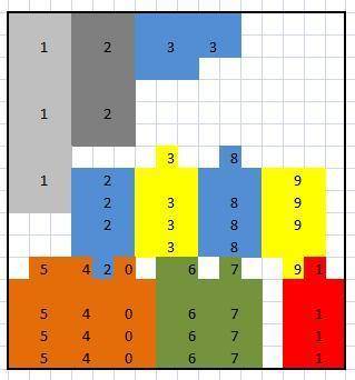

Here is a solution with 254 tiles:
Consider a 2x2-block
a b

Edit: Improved design for 0, 4 and 5:

Edit4: In any way, it fits in a 16x16-square without problems, see attachment. Even if there are some numbers missing, it is easy to add them.
You can combine 1/2/3/8/9 to save even more space without problems. This allows a reduction of at least 16 tiles. In addition, I would expect that many elements of the upper "3"-part are included in other elements, so this could shrink a bit, too.
