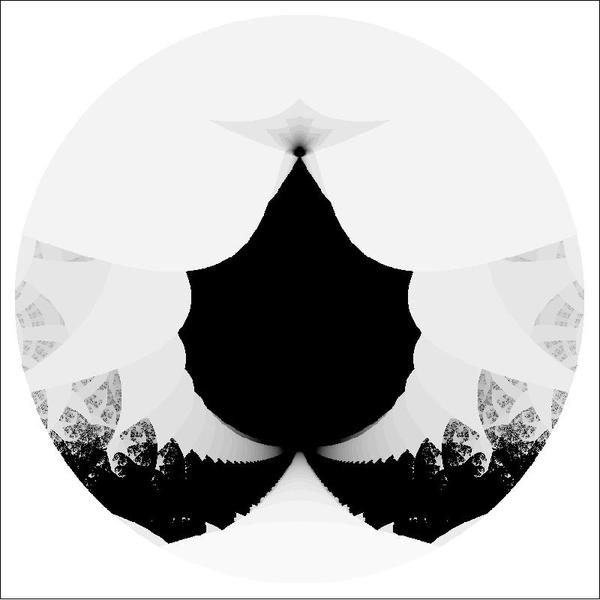

I don't understand anything about fractals, so be careful with this.
This is a few lines written in Mathematica which I think tries to do what you are asking for. It creates a square matrix of z^z^z... as long as the z^z^z are within a distance of 2 from the origin. Some wiki page said that was the criteria for escaping to infinity. It only builds a tower of z^z^z... 20 levels high before it bails out and assumes it will never escape. Then it displays a plot of that table. It does this over -2<=a<=2, -2<=b<=2 with steps of .01 for a and b. Norm[] is a function that calculates the distance from the origin to a point.
In[1]:= ArrayPlot[
Table[n = 0; z = a + I*b; r = z;While[Norm[r] < 2. && n < 20, r = r^z; n++]; n,{a, -2., 2., .01}, {b, -2., 2., .01}]
Out[1]= <plot snipped and attached>
I assumed your equation wouldn't be fractal because it seemed too simple to me. The first half dozen times I tried this I got a round black disk and thought I was right. Then I changed something to try to make this more readable and got a black sheet. That seemed wrong and I changed all kinds of things before I got the attached image. This may still be wrong, but you need someone who knows a lot more than I do to tell if this is right or not.
If I have errors in this and someone can explain how I am supposed to fix it then I would try to do that.
Mathematica is not free. For some it isn't even cheap. But it does run on Mac. If you ask very very nicely you can get a free trial version that works for a couple of weeks or a month. If you arranged to have nothing else to do and didn't sleep and you saw how to ask questions about Mathematica so you quickly got good answers then you might be able to learn a lot and get a lot of fractal images from various equations done before your trial expired. I would suggest getting an introductory book on Mathematica and learning as much as you can before you ask for your trial so that you don't spend your limited trial time frustrated with little problems instead of getting good pictures done. I don't think the trial lets you save files, so you may be limited to capturing the images on the screen.
If you want a few more images of this changing the location, the resolution, the maximum number of steps or zooming in on part of this then I would offer to do a few more experiments to help you get ready to start doing this yourself.
If after your trial you decide Mathematica is the tool for you then there are somewhat reasonably priced versions for home use. Add the price of a couple of books that will help you learn how to use it and you can try to learn to do fractals and lots of other things.
One other caution. As you see, Mathematica can be very flexible and you can change the function you use as well as anything else, but such flexibility sometimes comes at the price of speed. The simple example I showed will be substantially slower than a carefully optimized program written by an expert. It is sometimes possible to speed up Mathematica calculations, but that often requires more knowledge than a beginner can easily find.

Thanks a lot! That thing looks really cool! What did you change about the equation?

I tried to use what I thought your equation was, that was to check z, z^z, z^z^z, z^z^z^z,... until that was either a distance of 2 or more away from the origin or until it had a stack of 20 exponents and I bailed out.
The fumbling around was trying to make the example as simple and understandable as I possibly could, so you or others could hopefully understand it and point out any mistakes.
If you are fairly sure what the equation should be then you might be able to calculate the result for some particular value of z. If you let me know what the values for z and powers of z are then I could see if I'm getting the same result you are. That might help expose mistakes.

You've got the idea, that's exactly what I want to do. How long did that take your computer to render? By the way, I was not even sure if it would be a fractal. I had no knowledge going into this what it might look like.

For the simple example I showed: about 35 seconds.
Cut the step size in half, so 4x the points, and raise exponents to 40: about 5 minutes 40 seconds.
I'm not sure whether doing the repeated multiplies would be slower than doing the arctan and cis and log or not.

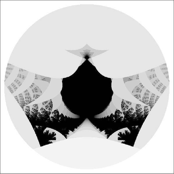

This is great. It appears, at the bottom left and right of the set, that points outside the radius of 2 converge. Could you make try making the set bounded by a circle of radius 3?

I still have no idea whether this is correct or not.
I'm guessing the wiki "diverges for x>2" may only apply for repeated squaring and not for your exponentiating
In[1]:= ArrayPlot[
Table[n=0;z=a+I*b;r=z;While[Norm[r]<3.&&n<20,r=r^z;n++];n,{a,-3.,3.,.01},{b,-3.,3.,.01}]
Out[1]= plotSnipped
In[2]:= Export["zfrac3.jpg",%,ImageResolution->200]

Do you know what it means if an area is grayer than another area? Is that based on escape time?

The darker it is the more z's in z^z^z^z... were needed before the value of that became greater than 2 (or 3).
So out side the circle of radius 2 (or 3) is white because it took zero exponents to be greater than 2 (or 3), in other words z was already enough.
The slightly darker shade just inside the circle took one exponent, z^z to escape. The next darker shade in the "bands" on the "wings" took two exponents, z^z^z to escape.
The black center did not escape in 20 (or 40) exponents.
