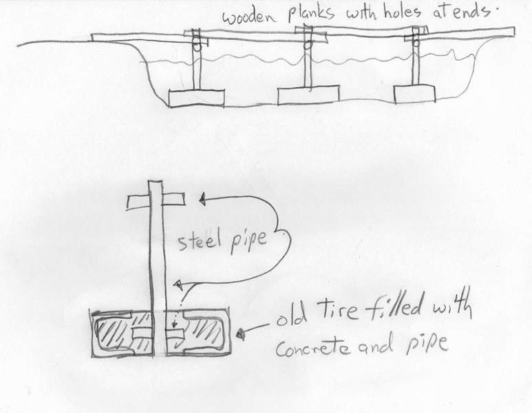

I live near a park that has two large hiking areas divided by a stream. If those areas were linked by a bridge the number of possible hikes that could be taken would be increased. The stream at one "crossing" is about 30 feet wide and normally has a small flow of but always enough water so you can't cross without getting wet (sometimes stones get lined up but higher water moves them. I'm guessing that at times water up to two to three feet high with flows of say 10 miles an hour can occur. Below is a scan of what I think is a simple and relatively inexpensive bridge design. How might you improve this design or is it fundamentally flawed?
Thanks for any help!

I suspect that getting a bridge approved will be more difficult than building one.
For your design - numbering the planks left-to-right - I'd put planks 2 and 4 on top of plank 3 to keep all planks level. If the high-water flow can move stones around you want to make sure that peak flow won't move the tire+concrete+pole - remembering that debris will pile against them.
Some people may have concerns about the tires breaking down in the water over a long time ... I wouldn't know how important those concerns would be compared with general levels of pollution, in the area, from other sources.
My personal thoughts are that, in many places, when you build something for general use, and someone gets injured using it, you find yourself under criticism. Look through your design for avoidable ways people could get hurt ... like: you'll want to cut the pipe so the ends sit below the hole - paint the ends of the raised planks (1 and 3) white (or with danger stripes), stuff like that.
Lastly - have you compared with other building methods?
Aside:
NZ has a lot of bridges or raised walkways in the context you are looking at - the usual approach is to use treated pine or macrocarpa. Poles are set in concrete and lowered into holes bored in the stream-bed... two for each span. I've only seen the tire+steel-pole approach for holding up volley-ball nets.
What Simon Bridge said. You would probably have a lot less bother if a 50 foot tall tree "accidentally" fell across the stream, than getting permission to build your desigm.
If your design isn't securely fixed to the stream bed (not just resting on it), there is no guarantee it will still be there after the first flood of water. A tire full of concrete only has the same density as a rock, so it's just as easy for the water to move it.
The current could also wash away the stream bed from underneath your tires (unless it is solid rock) which would soon make the bridge in unstable.
As this is a stream were dealing with you will probably also have to have a minimal depth to sink your uprights into. Tires filled with concrete by itself will not prevent stream flow from undercutting under the tires
Spinnor,
steel pipes rust
bicycles (and people) slip off a narrow plank and fall into the stream
wooden planks become more slippery when wet
And, the liability issue already raised by Simon Bridge above
Rather than trying to "reinvent the wheel" why not research how others have solved this?

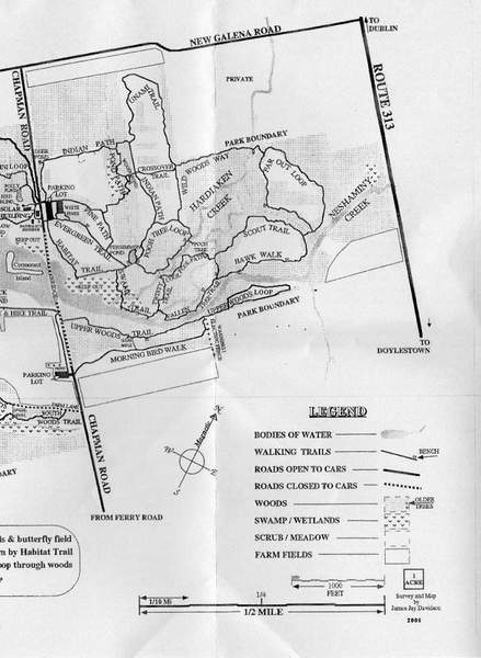

Went for a walk and "studied" the site. It appears the crossing is greater then 40 feet wide. A couple of inches of loose gravel covers bedrock across the stream bed. Even after a good rain two or so days ago the average depth of the water was about 3 inches. Various sized rocks made a foot path across the stream, with most rocks out of water. A hiking stick allowed me to cross without my boots getting soaking wet. Bikes are not allowed on the hiking trails. Rocks of size about 12x10x42 inches (about 270lbs.) have been at this crossing for years as well as smaller sized rocks.
A design factor that should be considered is the fact that if there were an easy way to cross the stream said crossing would probable not get a lot of use and so probably does not warrant any significant expenditure.
While I'm not convinced my design (with refinements from previous comments) is fundamentally flawed for this crossing I now think there is a better way forward. I see two options now, see scan below. The crossing is located at the south-eastern most trail in the park, of the Upperwoods trail and the crossing is at the south-eastern most part of the trail. The park owns land on both sides of the stream and trails could easily be made to the north-east linking state highway 313. There one could cross the state bridge over the stream, that is option one.

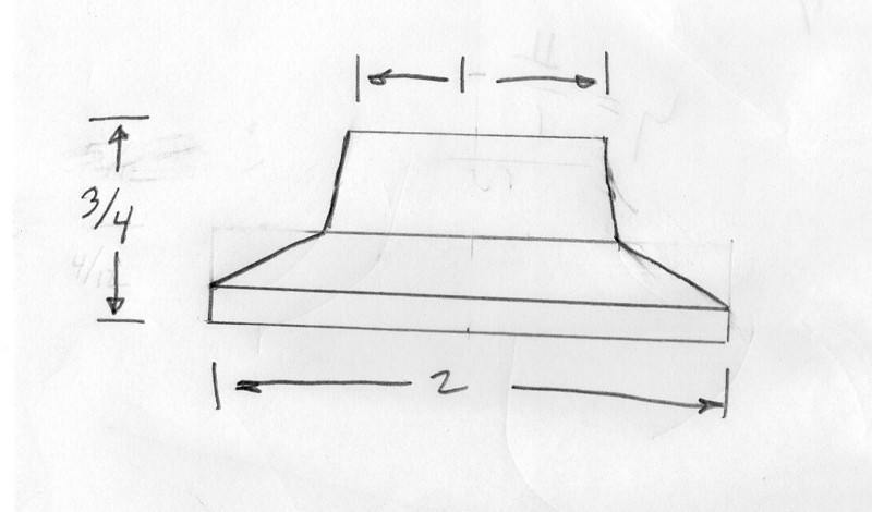

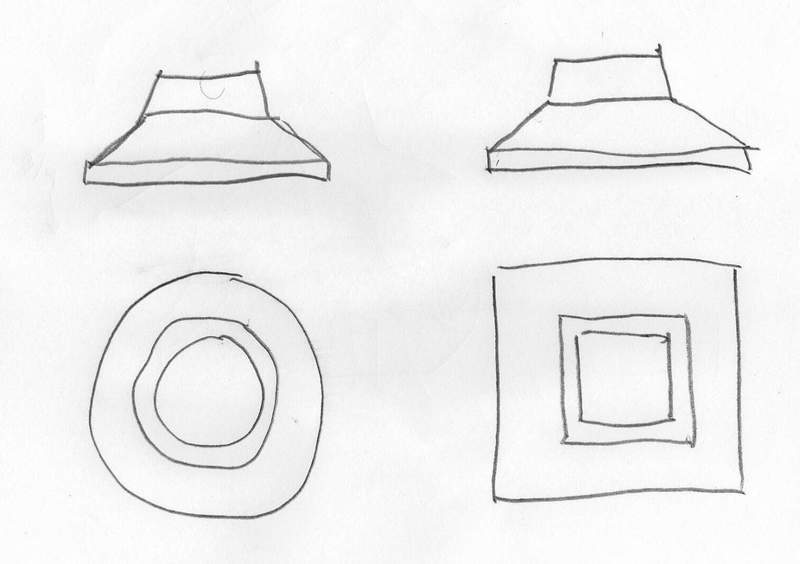

The other option involves cast concrete stepping stones, of starting size about 2 foot base, 1 foot "flat" on the top and a height of about 3/4 foot. Such a cone made of concrete would weigh about a 190 lbs., would cost less then 12 dollars in concrete and could be moved by wheel-barrow. The shape could be optimized against "tipping" and moving by water currents (care to optimize shape, and spacing, straight line or zig-zag?). See a sketch of a possible "ideal" shape. For the entire crossing I would need about 20 such cones. That is still a lot of work for a seldom used crossing.
Thanks for any suggestions!

Spinnor said:
Such a cone ...
Making the form-work for a "rectangular" truncated cone would be far easier but the "round" stepping stone has less "drag" for a given cross-sectional area but the "rectangular" cone weighs more. Which is best?

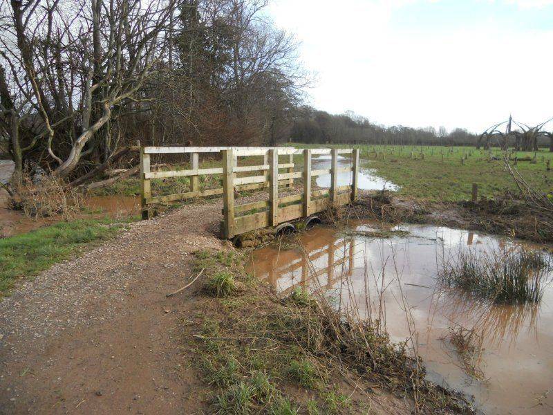

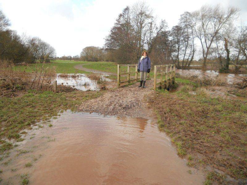

Went for a walk today in a nearby amenity area and took these pics of one of several amenity bridges for walkers and cyclists. It is over a small side stream like yours and formed by stanking around a flat row of large bore pipes with sandbags and infilling with rock chippings.

https://www.physicsforums.com/showthread.php?t=667304
As you can see there is some flooding, due to rain and meltwater at the moment since the park is in the valley. There is still snow up on Exmoor (SW UK) nearby.
Go well
Studiot said:
There is another photo from today here
Go well
