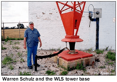

As usrdln stated, the entire structure is the antenna.
It is not a vertical quarter wave "whip" antenna which has lower radiation resistance, making it harder to drive, and is less efficient because it depends on significant current flowing in ground radials (counterpoise).
The Blaw-Knox is essentially a vertical dipole. Ground radials are often included, but do not act as counterpoise but simply shield induced ground currents from lossy earth.
The reason for the shape is that, since it is a dipole, its mouning point is swinging with high voltage and is insulated from ground with a large ceramic or porcelain insulator.
The mounting point is designed to have degrees of freedom for motion (rocking and rotation). This requires it to be a single physical point.
It widens in the center simply to provide structrual strength.
See attached photo.

Ceramic or porcelain mounting points are much more fragile than a typical tower mounting point. They are designed so that the only stress that they see is compression from the weight of the tower (where they can be strong).
A typical 4-legged tower mounting point (steel into a buried concrete footer) is designed to handle both the compression force from the tower's weight, but also lots of sheer and torsion stress. Sheer and torsion stresses come from, among other things, expansion of the metal due to temperature variation and wind loading.

So, essentially, the reason that the tower was made with a single contact point was so that the two balls shown here could simply rotate on top of each other, freeing the ceramic insulators from the torsion stress? How is it that modern towers get around this issue? Is it just better insulators that can take the torsion?
