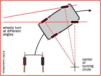

At very very low speeds, the car turns in the direction that the wheels are pointed. So your turn centre is in line with the rear wheels. Ie, draw a line perpendicular through the rear wheels and perpendicular to the front wheels.
Unless you have a geometry that allows the inner and outer wheels to take different paths (because the inner wheel is taking a shorter radius) you will scrub the tyres.
Reference: Ackermann steering angle
At higher speeds the tyre tread distorts meaning the tyre is travelling in a different direction than the contract patch. The angle between these two is the slip angle. This slip angle induces a cornering force which acts to turn the car into the turn.
This is the crucial thing. The lateral force caused by the turn induces a slip angle in the rear wheels. So the rear wheels are actually contributing to the turn. The centre of the turn (instantaneous centre) is now perpendicular to the slip angles front and rear.

Jan22-13, 02:03 PM   #28
I have another drawing that shows how all four wheels can be tangents to the curve they are following if the front two wheels are at different angles...

Quote by CWatters View Post
I imagine that the steering linkage can be made to do almost anything you want. It must be a matter of what makes vehicles corner best at speed.
