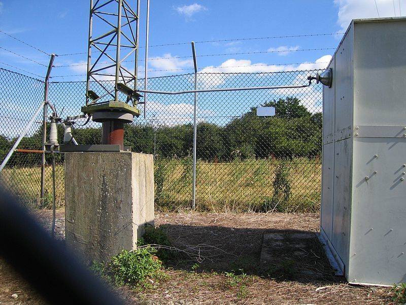

I have attached photo of feedline to a typical series fed tower. Feedline comes out of tuning shack to the right and attaches to antenna just above insulator. This particular tower is not a "Blaw Knox" type, but idea is same.
Fence surrounds it because there are thousands of volts on the feedline and the entire bottom of the antenna.
I also attached technical documentation for 314 meter high Blaw-Knox which includes schematic of tuning shack, impedance data, Smith charts etc.
Note that the antenna height is half wavelength at 540KHz. Also note that the antenna feedpoint impedance is about 300 ohms magnitude. If it were a quarter wave monopole the feed would be more like 36 ohms, and the required current an order of magnitude higher.
Driving this dipole at its midpoint (in textbook fashion) would be really impractical. You would have to install multiple fragile insulators halfway up the structure and relocate the tuning shack way up there.
