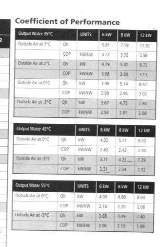

Jan28-13, 12:28 PM   #63
In which case you should carry on the process I have been advocating all along.
Using real world data.
Here is an extract from the manufacturers measured and confirmed capabilities of currently available heat pumps, I could buy off the shelf.
Note that the COP values are realistic not pipe dreams.

Jan28-13, 01:10 PM   #65
Quote by Studiot View Post
Around 3. What is the application being analyzed ? Heating a home ?
What does COP actually represent ?
What, from that chart is relevant to the proposal ?
I have no problem with real world data if it is applicable or is somehow relateable to what was proposed but I think the subject needs to be broadened somewhat beyond Heat Pumps and COP. Basically a "heat pump" is the same thing as a refrigerator, a freezer, an air conditioner,... There are many methods for cooling.
In a simple chart it is impossible to do more than be suggestive, so Heat Pump - COP, relatively understandable at a glance but only one possibility.
I has originally sent a PM to Low-Q suggesting that he might want to read Tesla's original paper on the subject crudely represented by the diagram but he didn't have time and as far as I know still has not read it.
Tesla's method of cooling was put forward simply as "By some means or another". Heat Pumps did not exist at the time. As I say, the diagram was only intended to be suggestive not technically accurate.
I think it might be best to make sure we have a clear idea what the intent was. Then it night be possible to consider what the options might be suggested by "Some means or another".
I know what the abbreviation COP stands for but really only a vague idea what it actually means. My impression is that it is very application dependent. How well does the appliance satisfy the requirements. The COP of a vapor-compression unit could be practically doubled if it is utilized for both heating and cooling rather than just one or the other.
If the kids turn up the thermostat the COP is reduced. etc. etc. It seems a rather wild variable to me and somewhat difficult to pin down. Neither am I an HVAC technician.

Jan28-13, 02:03 PM   #67
Exactly.
I have tried to show you, by direct calculation, that the COP and efficiency refer to different ratios, and are not just inverses.
In fact there are two different measures and definitions of COP one for refrigerators and one for heat pumps, which are thermodynamically different.
In a refrigerator we extract as much heat as possible for a given amount of work from the evaporator.
In heat pump we want to maximise the heat obtained from the condenser for a given amount of work.
This leads to different values of Q being used from different points in the cycle to define their COP = Q/W.
