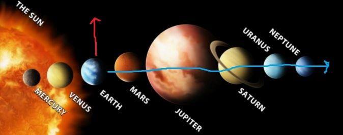

(a) What is the minimum speed, relative to the Sun, necessary for a spacecraft to escape the solar system if it starts at the Earth's orbit?
I am not exactly sure how to solve this problem. Should I use an energy approach? Do I need to calculate the escape speed for each planet, because it will pass by each one, and then sum all of the velocities together?

Regarding your solution, consider, for example, a trajectory perpendicular to the plane of the ecliptic. Would it pass by each planet?
I posted a picture of the two different trajectories. The line in red is the one I believe you are talking about. The line in blue is the one I was thinking about. Does the red line describe the trajectory you were speaking about?
Would it pass by each planet? Secondly, consider that your speed is that sufficient to escape Jupiter; would passing by Neptune need any more speed?
Well, it would seem like it would. Wouldn't the gravity of Jupiter pull on the projectile as it passed but it, thus reducing its speed? It then being possible that the speed is reduced by Jupiter's gravitational pull, the reduced speed of the projectile might then be not enough to escape Neptune's gravitational pull, to a place where Neptune's gravitational pull is negligible.

Yes, the red line would be one perpendicular to the plane of the ecliptic.
You have not said what you think "escape" means. Let's get this clear before we talk about anything else.
From my understanding, escape speed is the speed necessary to reach a point away from the planet where the gravitational pull is so small it is assumed to be zero, implying that gravitational potential energy is also zero. It is at an "infinite" distance. Does that seem correct?
Oh, so the red line is correct. So, that's why we only have to consider the escape speed of the sun and earth, because it doesn't have to pass by the other planets; and because the projectile is at an "infinite" distance from Earth's adjacent planets, that their gravitational pulls are negligible?
Being infinitely away does not free us from having to deal with the planet's gravity. In the end, we still have to deal with the Sun's gravity in the same situation.
