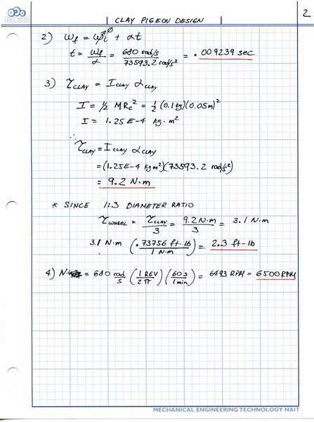

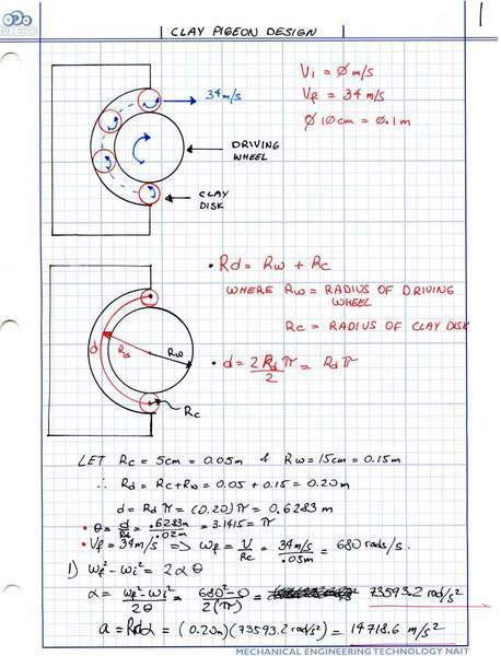

So I am stiff having issues figuring out the size of my motor. I have attached my calculations below. My numbers end up being ridiculously high and at this point I'm not sure what I'm doing wrong.
1) I want to find the RPM that the clay disk develops as it is accelerated to 34 m/s. At 4) I get it to be 6500 RPM, which seems unusually high.
2) The acceleration ends up being 14720 m/s^2 based on my circumference distance that the clay disk has to travel to reach 34 m/s. Also my time to do that is .001 sec
3) I calculated my driving wheel torque to be 2.3 ft-lb, now is there a portable motor that will be able to provide that kind of torque?

pantaz
pantaz is offline
#15
Feb7-13, 07:15 PM
P: 586
Quote Quote by ksukhin View Post
When you get a chance watch the video. The people in it did it exactly they way I want to do it but with a freebie and I think a bike wheel
That's a Frisbee launcher. I sincerely doubt a fragile clay pigeon can survive such a mechanism.
Every clay thrower I've seen uses an arm. The rotational speed of the clay is fairly low -- again, I doubt one could survive the kind of RPMs you're specifying.
