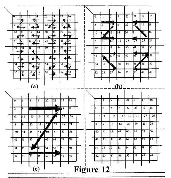

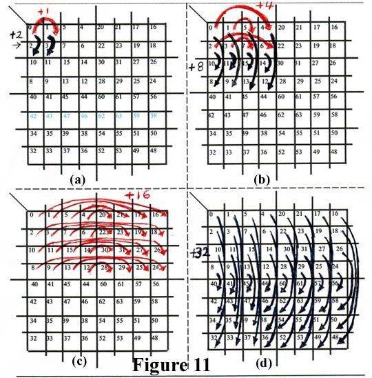

5. The Mahoney Map
5. The Mahoney Map​
In the early 1960s, Matthew Mahoney more precisely defined the basic mechanism through which the logic-map operates. Using this principle (which we have already laid out) he defined and laid out what came to be called the "Mahoney-Map". Essentially, the Mahoney Map is a variation of the Karnaugh Map, and the principles will apply equally in both cases.
Two examples explaining the workings of the Mahoney Map are shown in figures 11 and 12. The basic difference of the Mahoney Map from the Karnaugh Map is the fact that, where the K-Map can be laid out in either a "column-ordered" or a "row-ordered" manner (as we described in insertion number 2), the M-Map is laid-out in an alternating Row-Column manner - - - and can be numbered using a series of repeatingly reversing "Z" patterns. Explanation of the Mahoney Map is as follows:
The same reason that underlies Karnaugh Maps also applies to Mahoney Maps. This is illustrated in figure 11. There (in figure 11-a) we start out with one cell ("0") and expand from there by symbolically rotating that cell about the axis to the right, and adding "1" (2^0) to the original value (0), and putting the sum (0 + 1 = 1) into the new cell. Next we rotate two cells we now have downward, and add "2" (2^1) to each of the newly created cell values (0 + 2 = 2) and (1 + 2) = 3. Next (in figure 11-b), we rotate what we now have, to the right, and add "4" to each cell value to get (0 + 4 = 4), (1 + 4 = 5), (2 + 4 = 6) and (3 + 4 = 7). Then we rotate our new 8-cell group downward (again), and this time add "8" to each and get, values 8 through 15 (also in figure 11-b). Next (in figure 11-c), we rotate our cells right again, and add 16 to each. Finally here, (in figure 11-d), we rotate our cells downward again, and add 32 to each. This process, we can see, accomplishes the same thing as with the Karnaugh Map, except with alternating rotations to the right and then down.
There was also a method defined for drawing the M-Map, which is easy to remember. This consists of drawing in consecutive numbers starting at "0", and going through continually repeating and reversing "Z" patterns (as shown in figure 12). Observing figure 12-a, we see how the numbering of M-Map cells means putting in the consecutive numbers in reversing "Z" patterns. Cells "0" through "3" form a standard "Z", numbers 4 through 7 go in with a reverse "Z" pattern, numbers 8 through 11 go in with an inverted "Z" pattern, and numbers 12 through 15 go in with a reverse-inverted "Z" pattern. Also, as shown in figure 12-b, Those four, four bit entries also form a (larger) "Z" pattern. There are four of these larger "Z" patterns, which each also derive from four of the smaller patterns. The second of these larger patterns is also reversed, the third is inverted, and the fourth is reversed and inverted. Then finally, the four larger Z-patterns are themselves put in in a Z-pattern. Basically the K-Map and the M-Map configurations offer the same capabilities, and are used in the same manner. Comparative advantages of the two types are as follows:

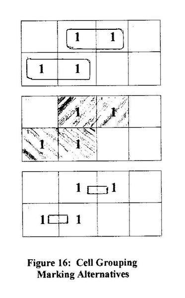

7. Karnaugh Map Annotation Choices
7. Karnaugh Map Annotation Choices​
In passing, we look at the various methods used for annotating the Karnaugh Map, not attempting to suggest or endorse any, but to indicate some things that have been used, and that might be used at various times in this string (sometimes because of the constraints imposed by the software being used here (MS Word, etc.).
First, brief mention is made of the ways used to indicate occurrence of a minterm* within the map. Figure 15 shows some of these. The top view, illustrates use of the value "1", indicating "presence" or "yes". This is the most commonly used indicator, though other marks, such as "X"or several other characters have also been used. The last entry, the "slash" was recommended by Mahoney for his map configuration. In this series of string insertions, the "1" shall be used (at least in most cases).
Figure 16 shows ways of grouping the cells (minterms) for minimization purposes. (The bottom style was recommended and used by Mahoney.) It should be noted that none is absolutely ideal in the case of complex maps of greater than four variables, because of the need which sometimes arises in those cases, to link non-adjacent cells.

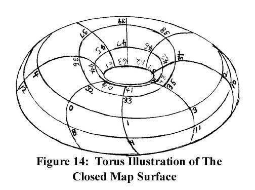

6. Closed Map Structure
6. Closed Map Structure​
The one point to be emphasized in this insertion, is the fact that the Karnaugh Map is a closed entity - - - thus it has no outside boundaries. Karnaugh himself described it as being like a torus, such as that shown in figure 14 (in this case, a six-variable map is shown).
Figure 13 is of a four-variable map showing the relationships across what appear to be the outside boundary axes (but since the map is 'closed' these axes are not outside boundaries). The first assertion we make here, is that the (so called) top axis of the K-Map, and the (so-called) bottom axis are not two separate axes, but are the same axis, coming, in this case, between the C'D row and the C'D' row. Arrows show the transition across this axis, Just as is the case across all other axes, one bit value in the representation changes (in this case, the "D" bit representation). Similarly, there is only one vertical axis between the A'B and the A'B' columns, and it is characterized in the same way, verifying that this is a completely closed structure.
KM

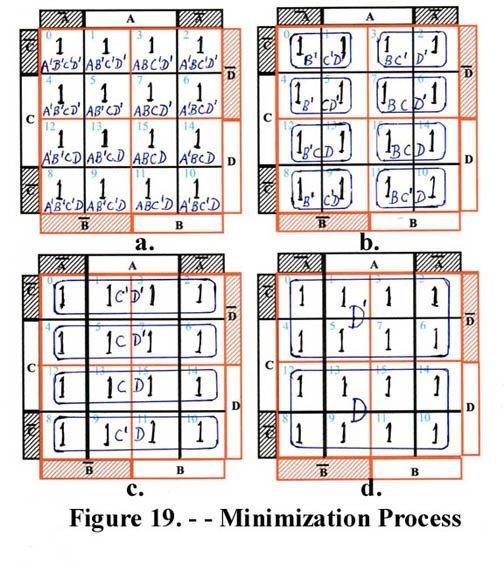

9. Dynamics of The Minimization Process
9. Dynamics of The Minimization Process​
The example shown here is not a practical application, nor is the method of solving the example the usual approach (there are too many minute steps taken), however it is intended to illustrate what takes place inside the map minimiation process.
In this case, we select every cell within the map to be 'marked'; in other words, all the minterms are present. This is shown in figure 19-a, in which every cell has a "1". We have additionally illustrated the values of the minterms represented within each cell.
In figure 19-a, we can see that each cell in the first column has a value identical to its adjacent neighbor in the second column, except for the value of the "A" variable. As an example, the values in cells "0" and "1" are A'B'C'D' and AB'C'D' respectively, thus when we observe these two cells grouped together (OR'ed) we get:
A'B'C'D' + AB'C'D' = B'C'D'(A' + A)
= B'C'D' (1)
= B'C'D' - - - - thus, we have eliminated the "A", and get cells "0" and "1" to contain what is in figure 19-b.
The same is the case for the remaining cell pairs between columns "1" and "2", and also those between columns "3" and "4". What we get then is that shown in figure 19-b.
In like manner, in figure 19-b, each cell-pair in combined columns "1" and "2" , has values that are the same as those in combined columns "3" and "4", except for the value of the "B" variable, thus if we combine (for example) the values of cells "0/1" and the values of cells "2/3" (by OR'ing them), we get
B'C'D' + BC'D' = C'D'(B' + B) = C'D'
- - - thus we have now eliminated the "B" - - - in the first row - - - and can do likewise for the other three rows.
What we have left, is the groupings shown in "C". Now we notice that the valus of the term in row "1" is the same as that in row "2", except for "C", and we thus have:
C'D' + CD' = D'(C' + C) = D'(1) = D'
The same is the case between rows "3" and "4", and we thus have:
C'D + CD = D(C' + C) = D
Finally, in figure 19-d, - - - if we combine (by OR'ing) the two remaining cell groupings, we get:
D' + D = 1
This simply implies that the "output signal" is "1" meaning that it is always present - - - and requires no logic to enable it.
This example, in a practical sense, is basically useless in the "real world", but it is also informative. It shows what takes place during the map minimization process.
KM

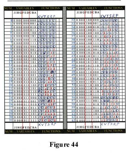

P.S. Some additional Truth Tables are also included to make it easier to work with eight variable Karnaugh Maps. One of these will be submitted soon.

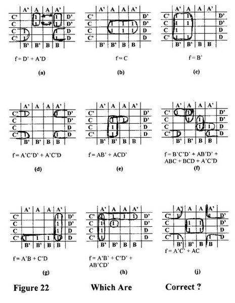

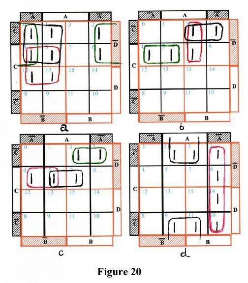

11. Filling and Grouping - - Examples
In this insertion, we solve a few maps to illustrate the straightforward application of the rules. First, we look at the example listed in insertion #8.
f = A"B"C"D" + AB'C'D' + A'BC'D' + A'B'CD' + AB'CD' + A'BCD' + A'B'CD + AB'CD
This has eight terms, all of which are minterms, so these can be entered directly into the map. This is accomplished by putting each minterm into the map cell who's position intersects the corresponding variable states. Thus, the first term in "f" goes into the first cell (# 0), the one which intersects the variables A', B', C' and D' (See rule # 1). The rest are entered in the same way, as shown on figure 20-a.
We then look for cells to collect into a group, while obeying all pertinent rules concerning grouping. By encircling cells numbered "0", "1", "4" and "5", we create a grouping that complies with all rules that are relevant (rules numbered 3, 4, 9, 10, 11 and 14), as is seen in figure 20-a. We then form three more groupings which also corellate to those rules(also shown in figure 20-a). Taken together these groupings also corellate to rules 12, 13 and 15, indicating that the groupings are valid.
When we then evaluate the groupings for the purpose of minimization, we see that each grouping contains four cells, meaning that two variables will be eliminated from each of them. Taking that first grouping (cells 0, 1, 4 and 5), we see that it symmetrically straddles the axis between "A " and "A' ", and the axis between "C' " and "C' ", so that by rule 19, these two variables are eliminated. On the other hand, this grouping intersects "D' ", but does not intersect "D", so that according to rule 20, "D' " is included in this term; and for similar reason, "B' " is included, (Rule 6 is verified) - - - yielding term "B'D' ". Then, similar examination of the other two groupings, gets us the terms "A'D' " and "B'C ", so that we end up with:
f = A'D' + B'C + A'D
Using the same processes, if we start with the following function:
f = ABC' + A'BC' + A'B'C + AB'C + ABC
- - we can put it into a map and group terms as is shown in figure 20-b, using much the same processes as were used in the last example. Note, that this example has only three variables, so that only the top half of a map is used. Solving this map, we get:
f = AB + BC' + B'C
Note, then that from figure 20-c, we can solve the same function, and get:
f = AC + BC' + B'C
- - - and this verifies rule 16.
Next, in figure 20-d, we start with a function that has Eight four-variable terms, and end with two two-variable terms:
f = A'B + AC'
This function is minimized in the same way as before.

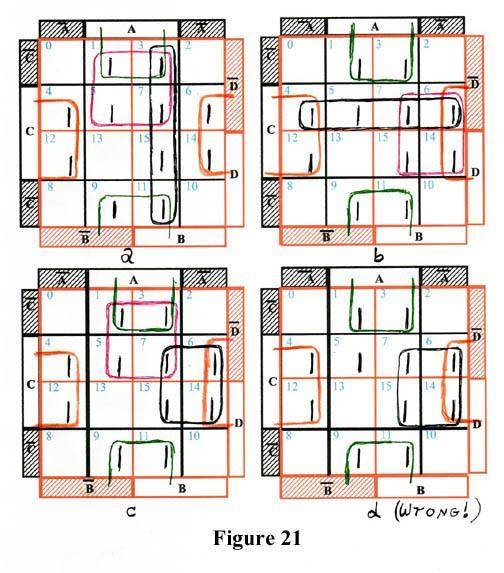

Finally, if we are given the following function:
f = AC'D' + B'CD' + BCD' + A'CD + ABD + AB'C'D' + AB'C'D
We immediately see that this is a four-variable function, and that also five of its six terms must be expanded to get a function containing minterms only. When we do so, we get:
f = AB'C'D' + ABC'D' + A'B'CD' + AB'CD' + A'BCD' + ABCD' + A'B'CD + A'BCD + ABC'D + ABCD + AB'C'D
This function is shown entered into each of the maps of figure 21. Comparison of "a", "b", and "c" of figure 21, shows three different, but all correct, groupings for this map, all leading to different but corresponding solutions. These are:
f = AD' + AC' + AB + A'C (figure 21-a)
f = AC' + BC + CD' + A'C (figure 21-b)
f = AD' + BC + AC' + A'C figure 21-c)
The last (figure 21-d) is incorrect because it does not adhere to rule 13.

12. What Is Wrong - - - If Anything?
12. What Is Wrong - - - If Anything?​
In this insertion, we study the rules given before - - with a few examples. Some, if not all of these in figure 22, are examples of mistakes in the use of the rules.
The example in figure 22-a, is incorrect, because, as shown, the two top circled areas are taken together, and as such violate rule 10. These two are not symmetrical across either the axis between B'-B, or the axis between A-A', and thus cannot be taken together . (In addition, in standard maps of four variables or fewer, all cells "circled" must be adjacent to each other.) In the future, for maps larger than four variables, we'll use different colors to show different groupings, for sake of clarity. The resultant function would be: f = AB'D' + A'B + A'D.
The example in figure 22-b, is incorrect. It violates both rule 10, and rule 4. The correct grouping must consist of two groupings, one including the the four leftmost marked cells, - - and the other, an overlapping grouping including the four rightmost cells. The resultant function would be: f = AC + BC.
The example in figure 22-c, is incorrect. It violates rule 14. A correct grouping would have three groups, one circling the top four cells, one circling the top two and the bottom two and one circling the entire left column. The resultant function would be: f = A'B' + B'C' + B'D'.
The example in figure 22-d, is incorrect. It ignores rule 3. If that rule had been followed it would be recognized that all four cells form an adjacent and symmetrical grouping. The resultant function would be: f = A'C'.
The example in figure 22-e, is incorrect. The vertical grouping shown violated rule 10 and rule 4. The correct grouping would have two groups. These would have; one group containing the top two marked cells and one group containing the bottom two marked cells. The resultant function would be: f = ACD' + AB'D.
The example in figure 22-f, is incorrect. It violates rule 15. There should be only four groupings (and thus four terms). One correct grouping would have; one group containing the two cells in the left (A'B') column, one group containing the two cells in the next-to-left (AB') column, one group containing the two cells in the next-to-right (AB) column and one group containing the two cells in the right (AB') column. The resultant function would be: f = A'B'C' + AB'D' + ABC + A'BD.
The example in figure 22-g, is correct.
The example in figure 22-h, is incorrect. It violates rule 11 and ignores rule 12. The circle enclosing the AB'CD' cell should also contain the top two cells of the first column and the top cell of column two. The resultant function would be: f = A'B' + C'D' + B'D'.
The example in figure 22-j, is correct. This example illustrates the correct observation of rule 3 that was missed in example 22-d.

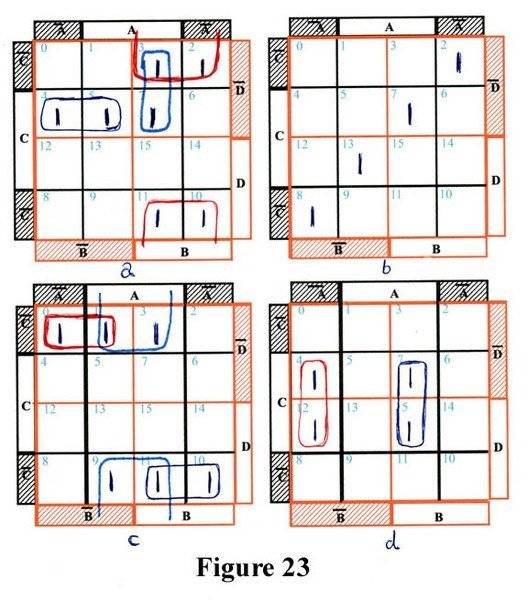

Following are four examples of the minterm entry, grouping for minimization and reading process:
1) Given the following function:
f = ACD' + BC'D' + ABC'D + A'BC'D + A'B'CD'
- - we expand this to get the following minterms:
f = ABCD' + AB'CD' + ABC'D' + A'BC'D' + ABC'D + A'BC'D + A'B'CD'
we put these into the map to get what is in figure 23-a, and this is grouped and read out to get:
f = BC' + B'CD' + ABD'
Note, that this is not the only possible solution function.
2) Given the following function:
f = A'BC'D' + ABCD' + AB'CD + A'B'C'D
- - we see that, since each of these already has four variables, they are all already in minterm form, so they are entered directly into a map, as shown in figure 23-b. Upon examining this map, we can also say that no grouping can be done, so that this function is already the most reduced form possible.
3) Given the following function:
f = A'B'C'D' + AB'C'D' + ABC'D' + AB'C'D + ABC'D + A'BC'D
- - we see that, since each of these already has four variables, they are all already in minterm form, so they are entered directly into a map, as shown in figure 23-c, and this is grouped and read out to get:
f = AC' + B'C'D' + BC'D
4) Given the following function:
f = A'B'CD' + A'B'CD + ABCD' + ABCD
we see that, since each of these already has four variables, they are all already in minterm form, so they are entered directly into a map, as shown in figure 23-d, and this is grouped and read out to get:
f = A'B'C + ABC

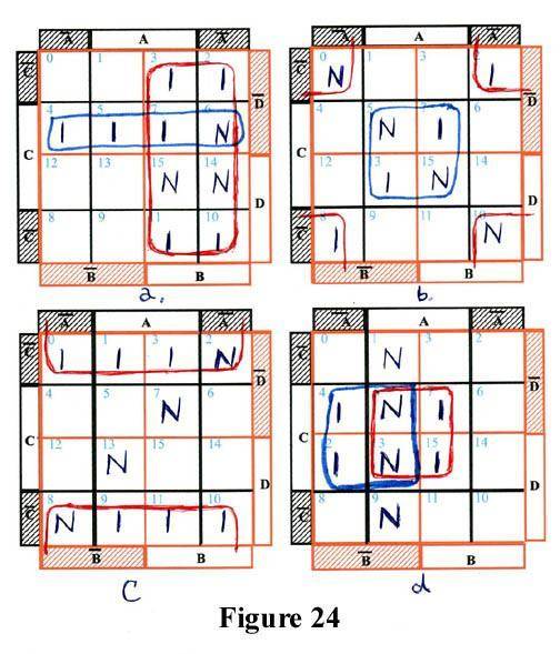

15. "Don't Care" Examples
15. "Don't Care" Examples​
The following examples, shown in figure 24, use the same four functions as were used in insertion 13, however in this case, certain minterm positions are also assumed to represent "don't care" cases.
1) We were given the following function:
- - and we expand this to get the following minterms:
We are also given the following "don't care" cases:
N = A'BCD' + A'BCD + ABCD
The expanded function minterms are entered into the map. Also, the "don't care" cases are already in minterm form, so these are entered directly into the map. What we get is shown in figure 24-a. In this case, we choose to treat all the "don't care" minterms as function minterms, because they greatly simplify the solution. What we then get is:
f(N) = B + CD'
2) We were given the following function:
- - and since as we saw before, each of these already has four variables, they are all already in minterm form, so they are entered directly into a map. No grouping can be done, so that this function is already the most reduced form possible, unless "don't care" terms are available.
N = A'B'C'D' + AB'CD' + ABCD + A'BC'D
These are also already in minterm form, and so are also entered directly into the map, and what we get is the map shown in figure 24-b. Now, we can group terms and reduce the resultant function, as shown in the figure, and we get:
f(N) = A'C' + AC
3) We were given the following function:
- - and since each term here already has four variables, they are all already in minterm form, so they are entered directly into a map. We are also given the following "don't care" conditions:
N = A'BC'D' + ABCD' + AB'CD + A'B'C'D
These are entered into the map along with the function terms, and we get what is shown in figure 24-c. Now, we can group terms and reduce the resultant function, as shown in the figure, and we get:
f(N) = C'
Note that, in this case, we chose to use some of the "don't care" terms and to not use others. That is totally our discretion.
4) We were given the following function:
and these were already in minterm form, and so were entered directly into the map, as was previously shown in figure 23-d. We were also given the following "don't care" terms:
N = AB'
- - which, when expanded gives us the following minterms:
N = AB'C'D' + AB'C'D + AB'CD' + AB'CD
These terms, when entered into the map along with the function terms, gives us the discretion to form the groupings shown in figure 24-d. From this grouping, we get the following:
f(N) = B'C + AC
Hopefully, these examples help to illustrate how the "don't care" can be used to help simplify the logic design operation. It must be remembered, however that by taking advantage of these constraints, we are actually designing a circuit that operate as planned only if the constraints are not violated. (This is a generally safe assumption, because whatever will violate the constraints would also cause problems in any case. It is still prudent to check for contingency situations after the circuit is designed.)
KM

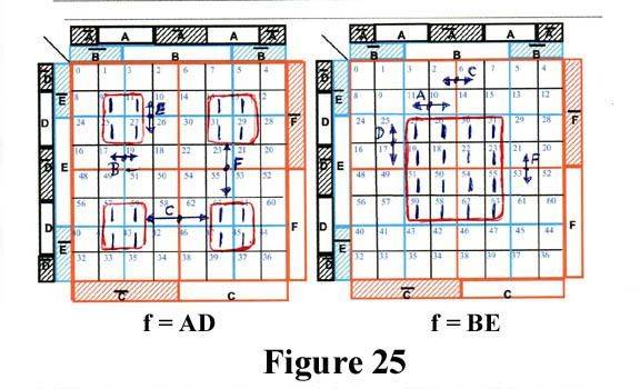

The rules concerning Karnaugh Maps, which we have already discussed, apply to maps larger than four-variables just as they do the smaller ones. The only noticeable difference in handling is the fact that groupings that are combined in the larger maps can now be non-contiguous (as long as they continue to obey the symmetry rule [rule 10]). To make it a bit more methodical, we establish something of a protocol for solving maps of greater than four variables:
1) Start each grouping at its smallest size at first, and build it up (mentally), via a "coupling" process.
2) When coupling two cell groups, every cell within one group must couple to a symmetrically situated cell in the other group.
3) When coupling four or more rows or columns (must be a power of two), start by coupling the two "innermost", then the two "next-to-innermost", etc., until the "two outermost are coupled - - - or at least one pair cannot be coupled.
4) Remember that, because of the "unfolding" way our maps are built, any two adjacent cells will couple. Also, remember that any two cells that are "symmetrical" will couple. The same holds for "groupings", thus any two adjacent or "symmetrical" groupings of the same size will couple, to form the next larger grouping.
5) Each time a larger grouping is formed, by coupling, one variable is eliminated.
6) Remember that, groupings must contain exactly 2^n cells, so that by starting with the smallest size and building the grouping up via coupling, this rule is maintained.

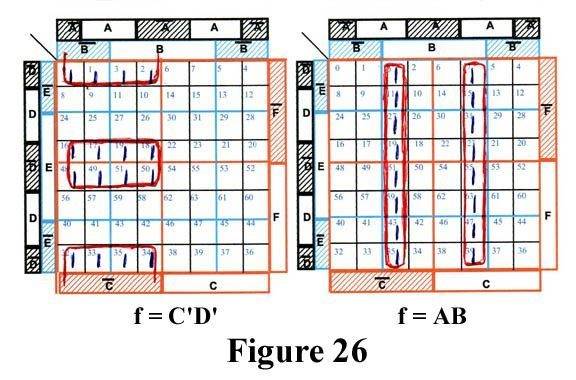

We can use this protocol for building up a grouping, with the filled-in maps of figure 25-a as an illustration. Starting with cells [9,11,25,27], we see that "9" and "11" can be coupled (and eliminate variable "B",as the arrows below the group indicate). The same is the case for "25" and "27". Next we can take the two groupings we have just formed, couple them, and eliminate variable "E".
Then we can do the same thing with cells [15,13,31,29] again eliminating "B" and "E". Next, we notice that the two 4-cell groupings that we have formed are themselves symmetrical about the axis from "C' " to "C", so that these two groupings can now be coupled (and eliminate "C").
Then we can do the same things with cells [57,59,41,43] and cells 63,61,47,45], again eliminating "B" and "E" (two more times), and then couple these two groupings (again, eliminating "C"). Finally we see that the upper grouping and the lower grouping that we have just formed, are themselves symmetrical about the axis from "F' " to "F", so that these can be coupled (eliminating "F"), and we end up with a 16-cell grouping, which has four variables eliminated from it, leaving [f = AD].
In the second illustration of figure 25 (25-b), we can first form the couplings to eliminate "A", then couple each of these horizontally, to eliminate "C". Next, we can couple each of these 4-cell groupings vertically to its adjacent grouping, to eliminate "D", and get two 8-cell groupings. Finally, we couple these two 8-cell groupings, eliminating "F", and end up with a 16-cell grouping. What we then get is [f = BE].
In figure 26, we can follow the same procedure to get [f = C'D'] and [f = AB]. We leave it as a practice exercise to do the same for figure 27.
This is all a straightforward operation, except for one thing - - - how do we determine whether two cells or two cell groups are symmetrical in these larger maps?

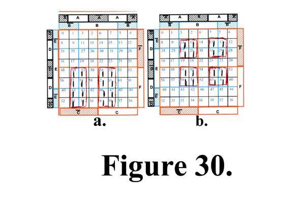

In figures 29 and 30, we have four cases, in which we shall determine whether 16-cell groupings can be made . In figure 29-a, there are two groupings of eight cells each, with both arranged vertically in columns. Obviously, each column can itself be grouped, since all cells within each column are symmetrical to that column's other cells (because they are all adjacent). The two columns themselves, however are not symmetrical, and thus cannot be combined to form a 16-cell grouping.
In figure 29-b, we cannot create full groupings either vertically or horizontally. Taking the top row, the reason for this horizontally can be ascertained in two ways: 1) The first two cell minterms will couple, as will the last two, but then the remaining two terms will not couple, because they have different variable sets. 2) The simplest way to state it, however is - - that where the cells [19,18] will couple because they are symmetrical, the other cell pair [17,22] will not couple with the first pair because the two pairs are not symmetrical. The same problem exists vertically.
In figure 30-a, there are two 8-cell groupings, but these will not couple because neither the inside columns, nor the outside columns are symmetrical with each other.
In figure 30-b, the cell groupings will not couple either verticlly nor horizontally. In both of these cases, the reason is the same that it was in the figure 29-c case.

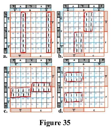

A few example cases are shown in figure 35. Fir each of the four cases, which, if any of these groups can be combined to form a 16-bit cell group?

Answer to the question of insertion 18: Only "d" is combinable to form a 16-cell group.

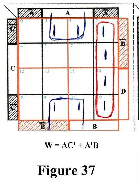

22. Truth Table - - - Use Example
22. Truth Table - - - Use Example​

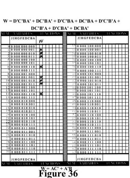

For a simple example, we are given the following set of terms, and asked to solve for the minimum.
W = A'BC'D' + A'BC'D + ABC'D' + ABC'D + AB'C'D' + AB'C'D + A'BCD' + A'BCD
To make this a bit easier to handle, it is suggested that the order of the variables of each term first be reversed:
W = D'C'BA' + DC'BA' + D'C'BA + DC'BA + D'C'B'A + DC'B'A + D'CBA' + DCBA'
Then, as the next step, we substitute "0" and "1" values for each variable, according to whether it is in its "negated" or its "asserted" state:
W == 0010, 1010, 0011, 1011, 0001, 1001,0110, and 1110
And then we assume these to be binary values, and substitute for them their decimal equivalents:
W == 2, 10, 3, 11, 1, 9, 6, and 14
Then, for each of the decimal values above, we enter a mark in that position on the truth table, as is shown in figure 36. (In the figure, stars (*) were used, but this was done only to make it reproduce clearly. Normally ones (1), or the like would be used.)
Next, taking the decimal values from the truth table "NUM" column, each corresponding position in the map is marked as is shown in figure figure 37. The map is then solved, and we get the following terms:
W = AC' + A'B
The resulting functional circuit for this is shown in figure 38-a, and its practical equivalent if, for example, implemented in TTL, is like that shown in figure 38-b.
NOTE 1: This is a simple case. Careful examination of the original equation would reveal to us that the "D" terms could have been immediately dropped out, and it could then have been solved as a three-variable problem. This will not always be readily apparent, however and it is thus advised that the cases be handled as done.
NOTE 2: It is here observed that functions to be solved, like "W" above, can also be expressed as "designation patterns" just as is each variable, thus as its designation pattern we would have had:
#W = 0111 0010 0111 0010
(This is simply the marked "pattern" that is entered under "W" in the truth table.) It is simply another way of representing the minterms of the logic statement.
KM

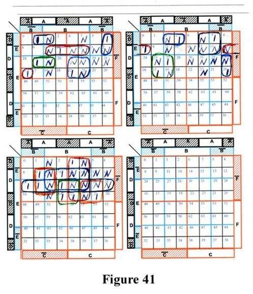

We then enter these values into our truth table, just as they appear in the table above, where:
1) D and C are the "variables" for the addend.
2) B and A are the "variables" for the augend.
3) E is the variable for the carry in.
4) Y and X are the functions for the sum.
5) Z is the function for the carry out.
These are entered into the table where the variables match the binary values of the table. We notice first, that the table values go in directly; with no need to convert from minterms. We also notice that some binary values of the truth table do not occur in the trinary systen (ie. where the value "11" occurrs, because there is no "three' in the trinary system), so in those places we put "N" for "don't care. The map, when filled, looks like that in figure 40.
The values from the truth table are then entered, by-the-numbers, into our K-Maps, as is indicated in figure 41. There are three maps, because we have three functions (X, Y and Z). When these three maps are then solved we might get the following minimized functions:
X = AC'D'E'F' + A'B'CE'F" + BDE'F' + AC'DEF' + BCEF' + A'B'C'D'EF'
Y = BC'D'E'F' + ACE'F' + A'B'DE'F' + AC'EF' + A'B'CEF'
Z = BCF' + AC'DF' + BDF' + DEF' + A'BEF' + ACEF'

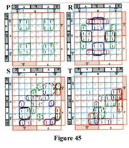

25. Combinatorial Circuit Example - - - 3 X 3 Multiplier - - - Part 1
25. Combinatorial Circuit Example - - - 3 X 3 Multiplier - - - Part 1​

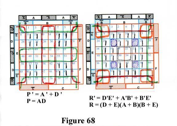

In this example, we create a simple binary multiplier, not part of an arithmetic unit, but one to be able to multiply two signals or controls, or to serve as part of a modulating function etc. It will take two three-bit input signal lines and multiply these, putting the output on a six-bit output line. This permits an output from zero to 49, derived using 6-variable maps. If a greater range had been desired, an eight-variable map would have given a 0-225 range, or a ten-variable map would yield a 0-961 range.
The basic pseudo module for this circuit is shown in figure 43. From it we can assume variables "A", "B" and "C" to form the multiplicand, and "C", "D" and "E" the multiplier. (Or you can swithc them around if you desire.) It uses our standard multiplication table (expressed in binary), so we can just plug the values right into the truth table. We get that which is shown in figure 44. From that, we enter each function ("P", "R", "S", "T", "V" and "X") into its own K-Map. The first four of these are shown in figure 45, along with possible solutions. The remaining maps will be shown in the next insertion.
This is a good place and occasion to practice solving a larger-than-four-variable map, so we shall attempt to do so here. Starting with figure 45, and the map for the variable ""P", we see that all the cells on it that are marked, representing a minterm presence - - - can be represented into just one grouping (circled with green). It represents a good example of what a valid non-adjacent group looks like. It contains some of the symmetries that were described, and when read out, the only variables that are not eliminated are "A" and "D", thus we get "P = AD ". Other maps are solved as follows:
The second map gives us minimized values for "R". This one works out to four minimized terms, all represented by non-adjacent groupings, and each grouping enclosing eight minterms - - before minimization is done. These include: 1) circled in 'red" - BDE'; 2) circled in blue - A'BD; 3) circled in green - AB'E and 4) circled in "black" - AD'E.
The third map encompasses nine minimized terms. These are: 1) in dotted green - A'CDE'; 2) in dotted black - ACDF'; 3) in orange - A'B'CD; 4) in green - A'BC'E; 5) in blue - BD'EF'; 6) in dotted red - A'BD'E; 7) in purple - AB'D'F; 8) in black - AC'DF and 9) in red - AD'E'F.
The fourth map encompasses ten terms, two of which cannot be minimized, and thus weren't circled, but must be accounted. These terms are: 1) in the upper red - B'CEF'; 2) in the upper orange - A'B'CE; 3) in dotted blue - CD'EF'; 4) in green - ACD'E; 5) in blue - A'BC'F; 6) in dotted green - A'BDF; 7) in the lower orange - BC'E'F 8) In the lower red - BD'E'F; 9) standalone - ABC'DEF' and 10) standalone - AB'CDE'F.
Hopefully, this will help to clarify how larger maps are solved. The remaining maps will be shown and solved in the next insertion.

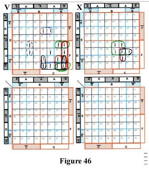

26. Combinatorial Circuit Example - - - 3 X 3 Multiplier - - - Part 2
26. Combinatorial Circuit Example - - - 3 X 3 Multiplier - - - Part 2​
The maps for the 3 X 3 multiplier are shown in figure 45 (previous insertion) and figure 46 (this insertion). Going through the remaining two maps (in figure 46), for the first, which represents "V", we get: 1) circled in purple - BCDEF'; 2) circled in dotted red - ABCDE; 3) circled in dotted purple - ABC'EF; 4) circled in green - B'CD'F; 5) circled in red - A'B'CF; 6) circled in black - A'CE'F; 7) circled in orange - B'CE'F and 8) circled in blue - CD'E'F.
For the second map of figure 46, there are three terms, as follows: 1) circled in green - BCEF; 2) circled in red - ABCDF and 3) circled in black - ACDEF.
Remember, that in a grouping, if 2^n cells are circled, then 2 variables will be dropped out of the term represented by that group. Solutions from these maps are as follows:
P = AD
R = BDE' + A'BD + AB'E + AD'E
S = A'CDE' + ACDF' + A'B'CD + A'BC'E + BD'EF' + A'BD'E + AB'D'F + AC'DF + AD'E'F
T = B'CEF' + A'B'CE + CD'EF' + ACD'E + A'BC'F + A'BDF + BC'E'F + BD'E'F + ABC'DEF' + AB'CDE'F
V = BCDEF' + ABC'EF + B'CD'F + A'B'CF + A'CE'F + B'CE'F + CD'E'F + ABCDE
X = BCEF + ACDEF + ABCDF
KM

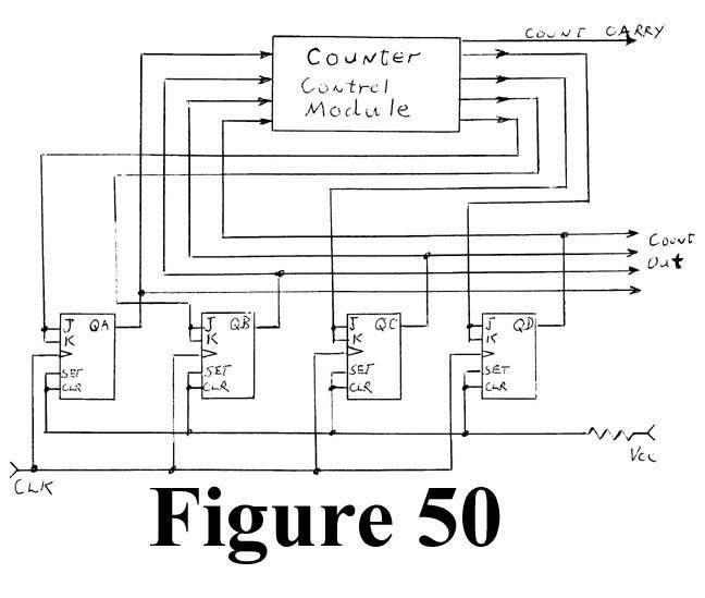

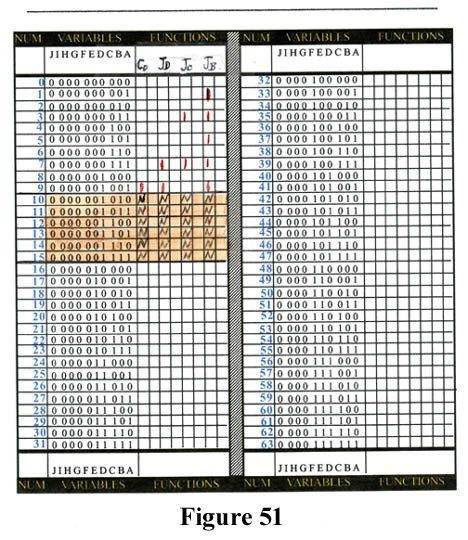

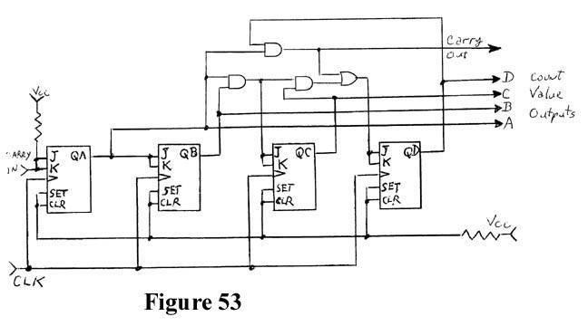

29. Synchronous Circuit Example - - - BCD counter
29. Synchronous Circuit Example - - - BCD counter​
This insertion is an application of the K-Map and its accompanying truth table, to the design of a typical synchronous sequential circuit - - - a BCD counter. As such, this unit will involve four J-K flip-flop units, one to hold each bit of the BCD value. It is our task to configure these count elements so that they will sequence properly through the BCD count range. We shall see, that using our approach, this is a fairly simple task.
The basic circuit consists of the four J-K flip-flops that are dedicated to containing our count value, as is shown in figure 50 - - - plus some,as of yet, undetermined logic that will cause the values of our flip-flops to cycle through the BCD values, synchronously, as they receive pulses to their clock inputs. For our purposes, the "set" and "clear" inputs to the flip-flops are not needed, and are thus kept tied to a high input (Vcc) value. Also, the Q' values are not needed and are thus not shown, All of the counting is controlled simply by toggling each of the flip-flops at the proper times, and thus their "J" and "K" inputs are tied together. Whenever we need to toggle them, we put a "1" value on them. Otherwise, we hold them at "0". The circuitry that will control this action is the "counter control module" shown in figure 50. This module takes the "Q" values from the four flip-flops, and from those, determines which flip-flop(s) to toggle at the next clock, and for the one(s) selected, sends a "1" value to the "J/K" input(s).
To determine which flip-flops are to be toggled at each count, and thus to define the logic equations and the resulting logic, we simply observe our BCD count values into the truth table, as is shown in figure 51. In order to know which flip-flop will be enabled to toggle at each count value, we simply observe which ones are to change. Thus, for example, the lowest order flip flop will change at each count (0 to 1 to 0 to 1, etc.) thus that flip-flop will always be enabled. We simply tie it to "1" (Vcc). The "third" flip-flop, on the other hand, will only change value (toggle) on two occasions, when it is at "3" and goes to "4", and when it is at "7" and goes to "8". For each of the four flip-flops (except the first, which is the trivial case), we mark in the truth table where it is about to 'toggle'. Thus, for the second flip-flop (Jb), we mark in five places, for the third (Jc), we mark two places, for the fourth (Jd), we mark two, and for the carry (Co), we mark one place. Thus what we get is the truth table as is filled in in figure 51. Note also that, since this is a BCD counter, values "10" through "15" are not used and thus are marked as "dont-care" values.
The next task is simply to transfer our truth-table entry values into our Karnaugh maps, one for each of our functions (Ja through Jd and Co). In actuality, "Ja" is the trivial case and need not be transferred to the map. What we get then is the maps shown in figure 52. The nice thing about our approach with this example, is the fact that we didn't have to first figure out our initial Boolean terms and translate these to the truth table. We went directly from our count values to the table, putting the values in, more-or-less, by the numbers. The resulting logic for these functions, which will define our circuitry, will be shown in the next insertion.
KM
P.S: Note that where we didn't use the "Set" and "Rst" values here, we have them available if we wish, for such things as manual setting counter, etc.
