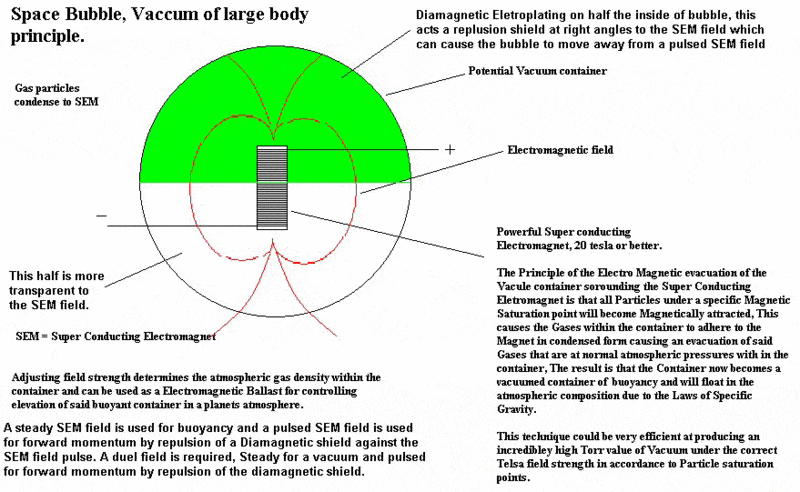

Considering all the Technicalities of Fusion engines, Wouldn't an EMP Engine over take a Fusion Engine.
Considering that the EMP engine is made with optimal efficiencies.
Capacitors can be charged over a timed array to give multiple EMP bursts to a super conductive Magnet in which an expanding field collapses off and repels off a diamagnetic shield, Specialized Diamagnetic shielding could help in increasing the EMP pressure by making special active polarization diamagnetic molecule that can change its orientation by electrical induction, This would allow the transparency of a diamagnetic shield to be controllable.
My Space bubble in design uses a type of EMP drive.
please see: https://www.physicsforums.com/attachment.php?attachmentid=5726&d=1133427767
Please excuse any typos.:smile:
Basically, an EMP system must impart momentum/kinetic energy to some propellant, presumably whatever particles atoms/nuclei are collected in space.
One has to look at the particle density and available mass flow in, which will then constrain the mass flow out, and then on must detemine the [itex]\frac{\partial B}{\partial t}[/itex] in order to determine the energy imparted to the flow. I am not aware that high magnetic fields have been obtained with large solenoids. High fields have been obtained on small SC magnets, however, the maximum field strength is apparently open to dispute.
