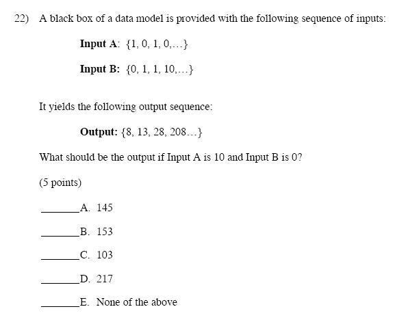

I was looking through some old exams for my engineering class and uncovered the following question...
If you would like to know the answer please scroll down and highlight the text
But I don't have any clue how to get it. If anyone can figure it out that would be great... thx
-tom
Answer: E

so far all i got is the difference between
8-13 is 5
13-28 is 15
and 28-8 is 20
working on this idea.
I have also found another thing that may help
the problem is 2 dimensional linear equations

If the equation is linear, then in my opinion, there is a typo in the question. Perhaps it should read:
Input A: {1, 0, 1, 1, ...}
Input B: {0, 1, 1, 10, ...}
Output: {8, 13, 28, 208, ... }
If this is the case, the linear equation is f = -7 + 15 * a + 20 * b. Then the inputs a = 10, b = 0 would produce the output f = -7 + 15 * 10 = 143. Since this is not one of the first 4 choices, the answer is E.
