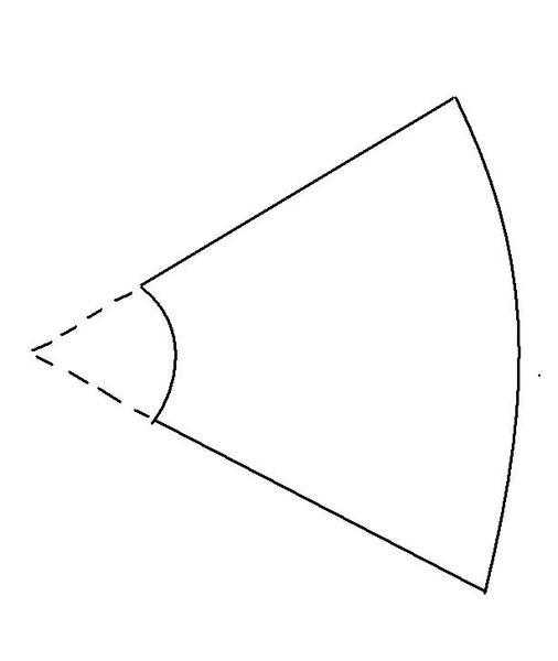

the flux due to the sun is now the area of hte sun less the area oh the spot. But the area of the sun is 100 times that of the are of the spot...
flux due the circular spot
the attached diagram is what i have in mind
the length of the arc of the sun is diamater of the sunspot
the the length of the arc near Earth is the diameter of the area where the solar energy is distributed.
is that correct now?? Also could you have a look at the other thread where the photn flux has to be determined? MY prof gave us a rough idea

I don't know, it says the figure hasn't been approved.
it has now!
that figure would be in 3d however.. would be a cone ?
could we simply use similar triangles here? in taht the square of corresponding radii of the circles is propertional to the areas of the circles?
That sounds right, though you may be overcomplicating a bit. Why don't you write your work out in equation form, it will be easier to check that you're on the right track.
ok so
[tex]\frac{7 x*10^5 km}{100 000 km} = \frac{1 AU}{r}[/tex]
now that we have the area of the curlce of the big cone and that hte energy emanated is the same for both the circles
[tex]\rho_{sunspot} A_{sunspot} = \rho_{big circle} A_{big circle}[/tex]
nowwe know the density of the energy reachng the earth. This is delta f? th susual flux ,f is 1380 W/m^2 ?

For the entire sun, yes. For the spot, you can use the cone approximation you were using before.
