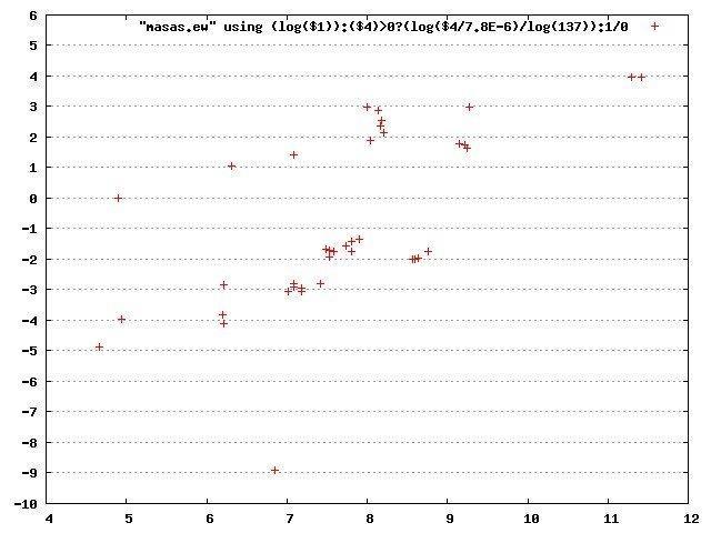

Perhaps it could be useful to add to the thread a couple of attachments, namely a .csv file of the electroweak particles (ie the particles having no predominant strong decay) and a McGregor plot (logarithm basis 137) of them. Part of the goal of this thread (the other being to get a sort of didactic guide) is to understand the slopes in this plot.

what is going on
the plot
https://www.physicsforums.com/attachment.php?attachmentid=6342&d=1140386375
shows two different groups, the ones of electromagnetic (say) decay, and the ones of beta decay. The group having beta decay adjusts to an slope n=5, because the Fermi coupling carries dimensions on mass square and forces a scaling behavior with the fifth power of mass.
The group of electromagnetic decay does not has such dimensional constant, and then it adjusts to n=3, a scaling with the third power of mass.
Now beyond this naive dimensional argument, I can not see how to explain other peculiar characteristics of the plot. Besides McGregor "quantisation" of the decay rates, one wonders why the neutron does scape from the group of beta decaying particles, gaining a stability a lot higher.
And, a lot more strange, how is that the fit for the electromagnetic decaying sector is so accurate?. The line scales exactly from the pion0 to the Z0, with a lot less dispersion that the fermi decaying group. Amazing, and it includes particles with different spin and different decay mechanisms.
Also, the Z0 is not a electromagnetic decay after all, except if you aniquilate the pair of quarks. And no such thing is possible for W, which just sits there in virtue of symmetry with Z0. We have thus an enigmatic coincidence
[tex]{G_F \over 6 \sqrt 2 \pi} \sum_f C_f (g^i_V^2+g^i_A^2)<br /> \approx {\alpha^2 \over 64 \pi^3 }{1 \over f^2_\pi}[/tex]
linking strong and electroweak quantities. We can use this coincidence to extract the value of a decay constant f and then to apply it to the charged members of the isospin multiplet, e.g. to a charged pion:
[tex]\Gamma\approx <br /> {3 \alpha^2 G_F (\cos \theta)^2 \over 64 \sqrt 2 \pi^3 \sum_f C_f (g^i_V^2+g^i_A^2)}<br /> m_\pi m_\mu^2 (1-{m_\mu^2/m_\pi^2})^2[/tex]
Does it imply a secondary n=3 scaling for the beta decaying mesons? Can not tell.
plotting
arivero said:
For gnuplot you need to input the orders
Code:
set datafile separator ","
set datafile commentschars "*"
and then you can procedd with the usual plot "data.txt" using...
Hmm better let me to put a fast introduction to gnuplot. You invoke it from the line interface, just writting "gnuplot", and then you use
Code:
set log x
set log y
plot "masas.txt" using ($1):($4)
and there you are!
You can enjoy some extra reference lines. Let me to scale back from the Z0 using both cubic and quintic powers
replot 2495.2*(x/91187.6)**3
replot 2495.2*(x/91187.6)**5
But perhaps it could be better to replot the quintic power from the muon...
and move the labels to the lower right corner.
Code:
set key bottom right
replot 2.99591E-16 * (x/105.658369)**5
You can notice that the muon scaling passes about a 20% of the tau decay rate. This is the right thing to happen, because we are just scaling the decay to electron and the tau has some extra modes available.

Putting Numbers in, II
I feel a bit alone in this thread :frown:, please feel free to add the data about your most favorite/hated book.
Meanwhile, let me to calculate, from the above table and plot, the reduced decay widths [tex]\beta=\Gamma/M^3[/tex]for the electromagnetic rank of particles.
  1. Neutral Pion
    [tex]\beta=7.8E-6(\pm6.E-7)/134.9766^3 = (562 [\pm22?] GeV)^{-2}[/tex]
  2. Eta
    • total
      0.00129 0.7E-4 547.75 -> (357 GeV)^-2
    • gamma gamma
      The \eta particle enjoys strong decays; we can do better if we check the tables (pdg) to consider only the gamma gamma decay, a fraction 39.42% of the total. Thus
      .0005085 547.75 -> (568 \pm?15 GeV)^-2
  3. Sigma
    Sigma is a baryon, thus a fermion. Its decay is to gamma plus Lambda, and amusingly the width still enters in the order of magnitude
    8.9E-3 \pm9.E-4 1192.642 -> (437 \pm?22 GeV)^-2
  4. Charmonium
    It seems natural to take the J/Psi, even if having spin 1. And it does the work.
    0.091 \pm0.0032 3096.916 -> (571 \pm?10 GeV)^-2
  5. Bottomonium
    As it can be seen in the graph, the Upsilon does not decay in the same line that the others.
  6. Z0
    Most fascinating, the electroweak scale and three generations tunes Z0 decay into the same reduced width
    2495.2 \pm2.3 91187.6 -> (551 \pm?1 GeV)^-2
    while W+ (which is a charged particle) is bit off average
    2124. \pm41. 80425 -> (495 \pm?5 GeV)^-2
Note that we need some pi and alphas to go from the reduced decay to the usual [tex]f_\pi[/tex], and some less to get an effective coupling [tex]g_{X\gamma\gamma}[/tex]; some papers have noted the equality of this last coupling when evaluated for eta and pi, but I haven't seen any work beyond it, nor a check of the other decaying particles as here we are doing.
To resume: when looking only to experimental data, we notice that the neutral EM decaying particles pi, eta, sigma0, JPsi have a common scale coinciding with the Z0 electroweak scale (aka Fermi scale), with respective numbers
562\pm22, 568 \pm15, 437 \pm22, 571 \pm10, 551 \pm 1
while the Upsilon family (third generation) does not seem to fit. The Sigma0 current pdg rate gives this 487 GeV; to enter in line with the rest the decay rate should be around 5.6 KeV, a 63% of the currently measured value (thus an even higher lifetime). But it is a fermion, while all the others in the line are bosons, so perhaps it is not reasonable to expect the same value. On other hand, it is a value measured via Primakoff effect, not exactly as the rest.
