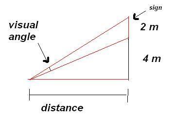

"The lower part of a 2.0 meters high road sign is at a distance of 4.0 meters from the car drivers eyes. It's difficult to read the sign at such a distance, as well as when the distance is too short. Investigate how the angle varies when the car is approaching on a straight road. At what distance is the angle as big as possible? The sign is readable if the angle is greater than 1. Investigate for how long time the sign will be readable"

I can explain the problem better.
You got a road sign ahead. The sign is 2 meters high, The distance from the sign to the ground is 4 meters. The sign is hard to see in a big distance. It is impossible to se if the visual angle is smaller then 1 degree. (which means that he can't se the sign on a big and small distance)
You're going to examine how the angle changes when the car approaches the sign and on what distance the biggest angle is.
See picture.
//jocke

I'm sorry I was posting for a friend who had troubles registering at this forum.
He posted a reply with a picture that clarifies the setting.(above)

No the sign is readable all the time whem the "visual angel" > 1 .
4 meters is the height over the ground as you can se in the picture. Alec wrote wrong, he missunderstood the problem. The distance and the angle are what you are going to examine.
jocke/alec, have you solved other problems in heights and distances ? What is the first thing you do ?
Okay, the first thing is to draw the diagram. So, what's the next step ? Is the diagram complete ? What's missing in it ?
The initial statement makes more sense then the picture. At least then you have some definition of a minimum reading distance.
How do you determine the minimum distance at which the sign can be read?
I have given you what you need to find the maximum, any distance less than that at which the sign subtends 1 deg the angle will be greater then 1 deg.
Integral, if you get directly below the sign, it subtends an angle of 0 degs - so there is a minimum distance as well. If you set up the equations for the triangles, you get a quadratic equation. The two roots give you the pair of end points.
