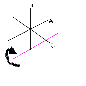

three identical thin rods each of length L and massM are welded perpendicluar to one another determine the monemt of inertia of the structure pink line is the axis of rotation. i think i need to use Icm= 1/12 ML^2 and I=1/3ML^2
but not sure which rod uses which formula

If the pink line is passing through the end of C then the MI for Rod C is 1/3ML^2.
For MI of A, think of the distance of different particles of the rod A from the axis.
For MI of B you have to use Parallel axis theorem. Go through it.
MP
thanks i got it now
