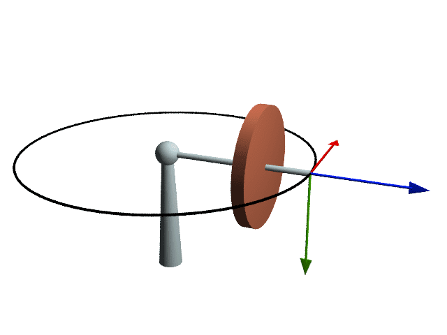

After reading in specialized Physics books and different articles, I’m still thinking about gyroscopical precession. I understand everything about angular momentum, torques…, but if center of masses makes a circular movement, Where does it provide centripetal force? Could it be for the axe friction with the vertical tower? In that case, I wonder, Could it make precessing a top or a gyroscope over a no frictional floor?
I’m waiting forward to listening to you or maybe you propose me any link about this question.

I understand the examples you explain. So, my doubt is still with me. We imagine a gyroscope with horizontal precess which receives a first impulsion to avoid the nutation as the one in the picture.
It’s right for me that center of mass moves with angular and constant velocity around fulcrum. Is it right? So, it makes that it will have centripetal acceleration towards this fulcrum. Is it right? And, finally, if it’s like that and we use the equation F=Ma(center of mass) I wonder where is this force created in case that the fulcrum hasn’t got friction. Is it OK for me to apply this equation in this case? I think it would be right.

In order for the gyroscope to precess about the fulcrum, the fulcrum must provide a centripetal component of force. If it doesn't, the gyroscope will slide off the support.
Doc Al is correct. If you look at a typical gyroscope, the end points are shaped like balls, and the tower tops are cup like to provide the small amount of centripal force to keep the gyro from sliding off.

On video 7.wmv how can it be gyroscope not falling? Why isn´t the force of gravity "mg" transmited by the support point to the floor?
Because the gyroscope is creating a torque force, in the direction that is upwards on the non supported point, and downwards on the supported point. The net result is there is a downwards force that equal (on average) to the weight of the gyroscope at the support point, not at the gyroscopes center of mass, so the platform doesn't fall.
