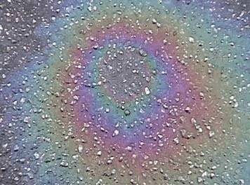

Here is one -- pattern.
I guess the problem could be cleaned up and simplified if we dispense with the water and use wet pavement, as in this photo. In this pattern, the surface is solid, all the light is arriving from the "upper world" and you get rid of the problem of light reflected from below the pond's surface. (Or below the glass kitchen tabletops). To idealize the problem further I guess you could smooth out the pavement.
The basic question still comes out about the same. Is there an image that could be extracted from this thin film interference pattern by performing a Fourier Transform? Or Reverse transform, convolution, whatever?
More directly, does a thin film type of interference pattern contain the information it takes to form an image?
Maybe a way to get at it is to try to figure out how, or if, thin film interference patterns differ from, say, double or multiple aperture interference patterns.
Thank you for your help on this. John
