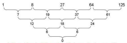

I’ve found that there are possibilities for writing formulas for polynomial sequences which are independent of the law or the equation ruling the them & I was successful in writing the formulae, with its specific range which depends on the differentiated function’s equation or in other words the rate of changes between the terms. The method used is mainly following a numerical triangle which is due to the laws of calculus, in order to write the formula I had to propose the ‘M’ theorem too, which states that all types of series have the number “m” which is the key for finding the next term, (read *logic behind M theory* p.2)
For better understanding about the value “m” let’s take an example,
The sequence: 1, 8, 27, 64, 125… which follows an equation ( n^3 )
The following chart should be plotted, (see dig1, attached)
In this example the number “6” is reoccurring and if we keep on writing the next terms of the sequence we will again end up with the number “6”, which I called it “m”.
The theory then states that the letter m + 24 + 61+125 = 216 = 6^3 = 6th term.
By using the same method we can write an algebraic expression for the letter “m” and the 5th or 6th terms, in the following way;
5th term = v 4th term = w 3rd term = z 2nd term = y 1st term = x
Hence m = [ ( w – z ) – ( z – y ) ] – [ ( z – y ) – ( y –x ) ]
m = w – 3z + 3y – x

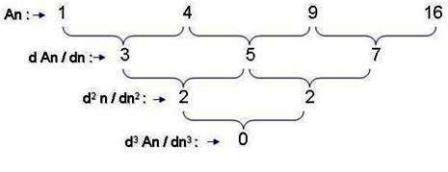

**The Logic behind M theory;
We can simply prove the theory using a little bit of calculus;
Take An = n2 (see dig2, attached)
By plotting the other points and connecting each consecutive point to the other by a straight line we can have their gradients so that we can then draw the graph for ‘d An / dn’ While we don’t mean the derivatives of the equation but the rate of change of terms.

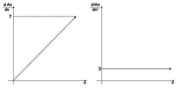

Now we can draw the graphs of ‘d An / dn’ & ‘d2An / dn2’ ;
(see dig3)
As shown above graph of ‘d An / dn’ is increasing with a constant rate of 2 units/n (shown in the graph
d2n / dn2) so when n is 5 the graph ‘d An / dn’ will increase by 2 units/n (d an / dn axis will show 9), hence when n is 5 ‘An’ should be increased by 9 which means 9 + 16 = 25 = 52 = 5th term.
When it comes to the numerical triangle, we are doing the same process done by calculus because when we are subtracting the two consecutive terms in the chart given on the first page, we are actually finding the gradient as given below;
(see dig4)
As a result; 0 + 2 + 7 + 16 = 25 = 5th term.

You might want to look up "Newton's divided difference" formula. Any sequence of n terms can be produced by a polynomial of degree n-1.
I'd suggest picking a name other than "M theory" - it's taken! :smile:
http://en.wikipedia.org/wiki/M_theory
I didn't look over your work too carefully but it probably does work for polynomials - but if the general term of your sequence is defined by a polynomial, it'll always be easy to calculate it anyways :-p
As Halls mentioned you can also interpolate sequences of arbitrary (edit: finite, of course) length to polynomials by just solving systems of linear equations (but this'll only get you back the terms you already have!).
