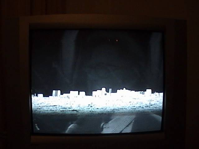

Anyway here is the thing...I have this video cassette player that i bought 5 years ago and it seems to have a piture display problem. This started last year...

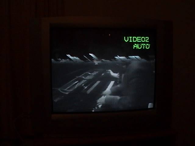

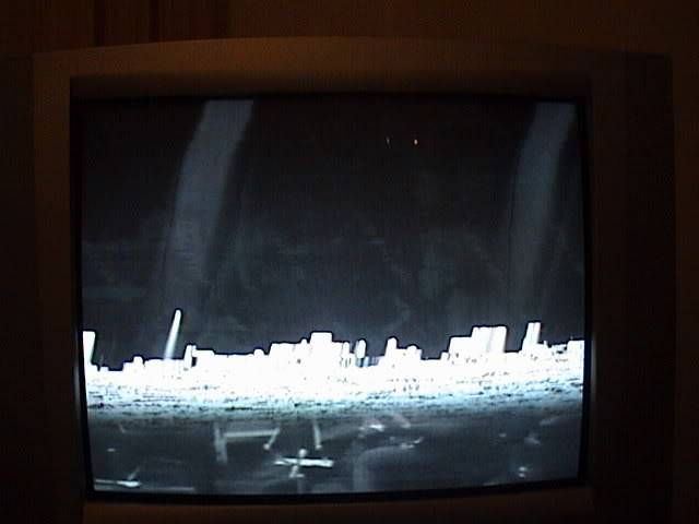

When i play a video cassette i get the sound coming quite clear on the tv but the piture is not clear at all...It looks something like this...
Yes that is Eric clapton that you see...The video is like that all the time...By the way its black and white and it keeps jumping all the time...As for those white lines you see i have tried tracking the video but it only gets worse or no better at all...

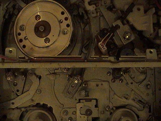

I thought that the head/drum might be dirty and cleaned it but no luck at all...Can anyone help me with this please?

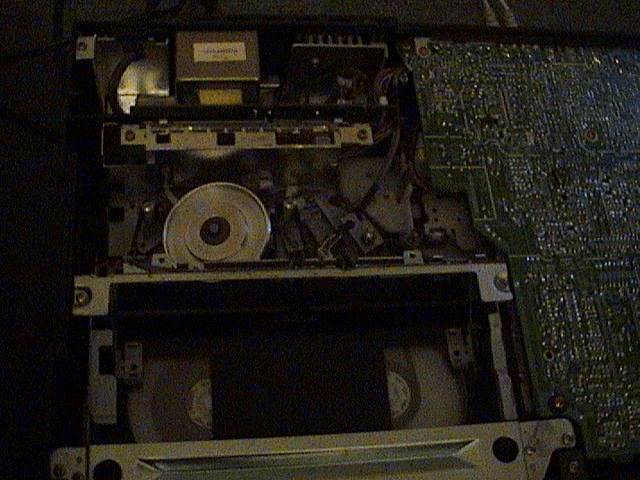

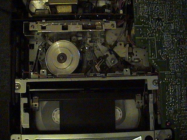

Here are some more pictures...
Here are some pictures of the inside of my video player...
Yea so i hope you understood my problem and would appreciate any help offered!

Looks like bad tracking to me.
Those "head cleaner" cartiages don't do much of anything. It probably has some goop on one of the guide posts or some other component in the tape path.
A professional cleaning might fix it up.

I know your suggesting bad tracking because you see those white tracking lines on the bottom of those pictures, but i tried tracking those pictures but no improvement at all...:frown: I don't think its worth taking it to a pro. to clean because with the cost of that i could probably buy a new one...:-p Thanks a lot for your help though...

The tracking adjustment won't help if there is goop on the guides, it just makes it worse.
I suppose you could try cleaning it yourself.

Did this tape always look like this? Or did it play fine previously and then begin to get worse?
Does the VCR play other tapes just fine, but have problems with this one?
It looks to me like it might be the MacroVision copy-protection system at work. Did you perhaps make a copy of an professionally-recorded tape, and then try to play it back?

This tape used to work well previously before and now its got worse...I tried the VCP with different tapes and i get the same result...:confused: ...And i never made copies of any tapes before...Infact i have never copied a Video tape ever...I have a feeling its not the tapes but something wrong with the VCP its-self...I going to borrow a Video cassette from the video library today and check it out...Ill let you know what happens as soon as i check it out...

There's another possibility which I didn't even know was possible until it happened to me. The heads on my Betamax wore out... nothing left to clean. And there I was with over 100 beta tapes. Luckily, I found a similar unit with a busted stage, so I could transplant the heads.

Worn heads tend to smear the whole pic into one fuzzy blur. It's actually happens a lot.
The images the OP posted were sharp enough with the exception of the noise bars from tape lift.
