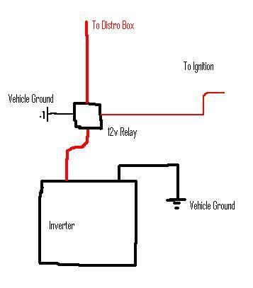

Find a 12V line in your fuse box that is only on when the motor is running (or the key is turned on). Use that to power a small relay that connects the battery 12V (through a suitable fuse of course) to the inverter. You probably want to use a smaller fuse than the inverter has on its input, since you won't be running it at full power.
Okay so I'm not to sure how to do what you just said. Let me add a little more info though. So I was going to run a 0awg from the battery to the trunk into a distro. I need to power my subs amp and the inverter off of it. Knowing this can someone get a clearer picture in my head or maybe a little drawing>
berkeman is suggesting to put a relay in series with the power lead of the inverter. A relay is a switch that can trigger on some sort of voltage source, in this case, the ignition signal. This means since the relay is in series with the inverter's +12v lead and normally open (off). When you turn on the ignition, it will close the relay switch which will power up you inverter. It's always good practise to put a diode across the relay coil to prevent any flyback from possibly ruining your car's electronics.
To find an ignition triggered wire, go to your fusebox with a testlight and poke around ontop of the fuses. If the testlight turns on and off when you cycle the ignition, that fuse is on an ignition triggered circuit. Splice into the wire coming off of that circuit. Personally I would put it on an accessory wire because it turns off when the car is cranking, and you can also turn the key into accessory mode with the car off to run the computer.

Okay great things are coming together now. I'm looking around to find where to buy a relay.http://www.robotmarketplace.com/store.html" Will this do just fine? Thanks again everyone you've been quite helpful.
