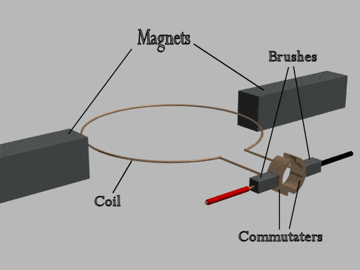

Are commutators devices, what change current direction? :rolleyes:
I mean if I want make my homemade generator model and it must be act DC or AC and i have a permanent magnets, some coil, iron stick and brushes. How do i make this commutators? I don't want make it, but it must be simplier understand in this way.
http://en.wikipedia.org/wiki/Electric_motor
The commutator is like a split slip ring i think, or two brushes that are in contact for [tex]\pi[/tex] rad, so you are effectivley supplying current to one side of the circuit then switching to supply the other, but at the same time the current polarity is reversed due to the rotation of the rotor, so you end up with a DC supply.
To build something similar you would need to have two halves of a split slip ring, with each connected to opposite sides of the circuit, and the rotor coil contacts on the rotor shaft make contact with the split slip ring?
ive never dealt with this subject before so i could be very worng...
Here's a simple drawing of a DC generator with the major components marked.
If that is generator. Why it has not iron stick in the middle of coil , because if that coil is copper it doesn't influence with a permanent magnets? I don't know, or must be coil almost made iron. :confused:
OK! But this topic is no more treat Electron move. So I ask, how large force must be, if we wan't get one electron moving?
The permanent magnets produce a magnetic field B. As the loop of wire rotates, the flux of B through the loop changes. From the loop's point of view, this induces an electric field around the loop, which causes the electrons to move.
