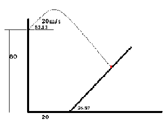

What do you do to find the x and y coordinates of a ball that is thrown from a building onto a slope?
*Initial velocity is given along with the angle
*The height of the building is given
*And the angle of the sloped ground is given

I should have been more specific.
Problem: The ball is thrown from the tower with a velocity of 20m/s. Determine the x and y coordinates to where the ball strikes the slope. Also, find the speed at which the ball hits the ground.
**Picture attached

first part with the slope though I just simply don't understand -- picture would help a lot
u need to know the slope
The picture is in the post above.
"Determine the x and y coordinates to where the ball strikes the slope."
The ball doesn't land on a flat surface. The ground is raised by an angle of 26(degrees) to the horizontal.
I hope that clears it up alittle better.
