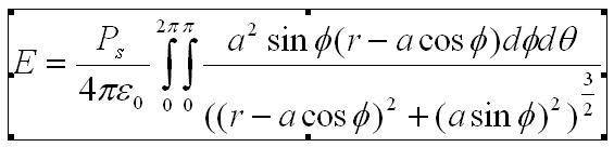

And what is the integral? I need to solve this using Coulomb's law. I don't think I'm getting the right integral.
Show us the integral that you got, and someone can probably tell you where your error is.
Alright,
if you look at the attached file, this is the integral I've got at the end.
Please note that this is for a sphere that is only charged at its surface.
Can someone tell me if I got it right? And if so, how do we solve this integral?
I believe that one integrates over a vector that is the sum of the vector from observer to the center of the sphere, and the vector that spans in spherical coordinates from that center over the sphere's surface charge.
Hmm? :S
