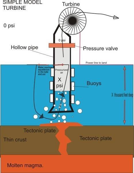

ok guys,
we've been fiddiling and fuming about all this nuclear reactors for the past few generations right? when all they essentially do is produce heat.
this heat drives a turbine which in turn produces electricity
ta da!
as we all know, nuclear reactors can pose a very dangerous threat to the environment if not dealt with properly. but we still end up with all the radioactive waist which is really a big downside...
why don't we use another source of heat that we don't need to "create"
we have at our disposal right underneith our feet some sereous heat!
what if we build a thermo-electric generator underwater, where the crust is thin.,
i know this has some sereoulsy technical diffuculties.
or even better, wat if we use these areas on our Earth's crust that are underwater and essentially build a hollow tube that submerges underwater toward all this heat.
all this heat (esentially lava and such) would mealt the water that is right above it (no need to worry about how much water you need)
i say you use this pipe and esentially guide all this steam up to the surface . but the real beauty of this idea is that, because you are putting all this "air" into a pipe that is underwater, and is open at the end. all this air rises through the tube right? but of course it builds up pressure at the top because the turbine is up top. because the water would want to reach equalibrium inside the tube and outside, you just need to get some air in that tube, and leat it build pressure.
then with your turbine, you open the valve that is over its intrance where the pressurized air is, and generate electricity.
although the generator can't be really big because you don't want too much air to escape at one seccond as to lose too much pressure within the tube. the exit flow of air must be less or equal to the amount of air coming in from the bottom (under water)
all this so you still have some pressure to work with -to drive the turbine-
a picture would be so much more usefull to describe this.
sooooo...
what do you think or am i just insane?
That technical difficulty is beyond serious. Iceland essentially gets its geothermal power from the mid-atlantic ridge, but for us, the mid-atlantic ridge is 12,000 feet under water and 2,000 miles offshore.
It just isn't accessable to most people.

I don't think it's insane, just very challenging. And when you get right down to it, in a few hundred years we're going to be looking for renewable (or very very large) sources of energy, and there are only a few possibilities. Solar is one, and variations on geothermal and water power and wind power are others.
To harness geothermal in the manner you are suggesting, we need to get better at deep drilling and well maintenance. I'd encourage you to research the state of the art in drilling technology, and see if you can contribute in some way. Drilling for oil and gas obviously drives the current state of the art, and if you can contribute, your initial contributions would probably be with that focus. But if you keep your vision of very deep geothermal drilling in mind, you could definitely help invent the technologies that would be necessary for deep-hole power plants.

thanks for you imput guys. i'll have to keep this one in mind.
obviously this design isn't pratical in this stage of technology.
but in the future, i think thermal power is going to be a big one for us.
regarding the drilling...--> why drill bits?
i know this sounds like its out of a sci-fi book or movie, but why not high powered optical devices or sound waves??
Niether of those technologies are practical for such applications given current state-of-the-art. There are simply too many problems with such things as beam occlusion, energy dispersal, etc.. I wouldn't rule them out in the future, but an awful lot more development is needed before they can be useful on that scale.
edit: I should mention as well that there is an awful lot more to drilling than just making a hole in the ground. Multi-section bits provide pumping action and mud circulation for lubrication, help support the walls of the hole, and can be manoeuvred for angled or even horizontal penetration. It's a very well-developed science that will be hard to replace.
