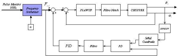

PATRICIAGS
Hi!
I Need to desing a variable frequency multiplier, I have a sinusoidal signal of 10Hz and I want to multiplier this signal and coverts it in a signal of 50Hz or 100Hz depending on a factor.
I think that I can do it with a PLL but I don´t know how to do it. If someone knows where can I find information about it or can give me some I´ll be grateful.
Thans

But as was asked already, are the input and outputs square waves or another waveform shape? Does the output need to be phase locked to the input? If not, what is the required frequency accuracy? And in either case, what phase jitter is allowed? Phase jitter is one of the most important specs when it comes to PLLs and frequency multipliers.
One way to design this would be to start with a higher frequency clock that you divide a constant amount and phase lock to the 10Hz input. Then run a separate variable divider down off the higher frequency clock to generate your 50Hz...300Hz signals. Quiz Question -- what is a good choice for that high-frequency clock? Why? (hint: choose the lowest frequency that will work for the divide ratios)

1. The two signals must be in phase, that why i thougt abaul the PLL
2. The two signals are sines, but yerterday i started designing one with an EXOR PD. I, m implementing this in simulation ( simulink of MATLAB), so is esay to transform sine wavws in square waves.
3.- I´m sorry but i have no idea what the phase jitter that i need is. I work in system control, and I´m trying to control a motor with a big whell ( more or less) and to control the position ( phase) Y have to compare the 2 signals to see if they are the same ( If the output is like the input), and for it i need that the 2 signals run at the same frequency. So, i don´t understand to much how i have to desing it, that is an small part of my proyect.

Well this is much more informative. Thanks for the input. What type of motor is it? Are you basically replacing the VCO with the motor in your application or is it an AC induction motor?
Freq Mult
Well, is dificult to answer becase i don´t know any thing about the motor, I have used a basical model of an electrical motor. And sorry but i don´t usderstand the second question.
I´ll try to send you the model of my system so you can make up an idea of what it is but i can´t give information about the components because the person that is doing this is still thinking about it, and i´m doing my work but is probably that in a few time i´ll have to chage it. But if i know how to choose the parameters for this case, i will be able to do it for an other case.
I attach the transfer funtion of the motor+wheel, and the model
I know what is the squeme that i have to follow to desing the sinthetizer but i still don´t know how to chose the parameters of the vco, for the PD i have put an EXOR, and for the filter a LPF Buterword, but for the VCO I have to chose the Quiescents Frequency and de sensitivity freq.
I have try putting
Fq=5
Sen=50
Because the VCO must be runing between 50 and 300 HZ and the input is 10Hz.
And then i have to multiplies the output signal from the Analog Filter block by a constant to produce the control signal of the VCO. And here i have done "trial and error", and it goes, more or less, but i what to know how I have to choose it, please.
Well i don´t know if is enough information for you to answer me.
