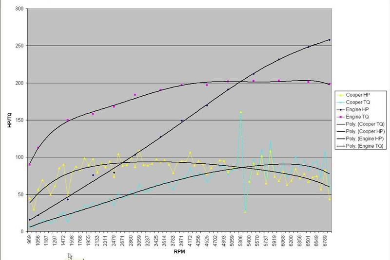

gt5816v
I'm trying to calculate a vehicles bhp based on acceleration.
I'm using RPM time stamped in milliseconds.
Tire Dia= 0.62738 meters
R&P= 3.23
3rd Gear= 1.66
Mass= 1500 Kg
Wheel speed= Engine RPM/(R&P*Gear)
Velocity= WS*Tire Dia*0.0523598
M*(Dia/2)*1000*((v2-v1)/(t2-t1))=Nm
Nm*0.001341022/5.3618= Ft.lbs
Ft.lbs*RPM/5252=hp
Does this seem correct? Obviously this does not factor for aerodynamic losses.

The times are not in milliseconds, but other than that your approach looks correct. When you correct the units on the timestamps and graph the HP versus time, what does it look like? Are you making your own in-car dyno? Cool.
Thanks for the reply. It's for a pda application that reads info from the OBD2 port. The time stamp should be ms... It's not relative to real time, just a timer. It does not reset when logging begins, perhaps that's the confusion?:confused:
What's kind of odd is that one car is providing very believable numbers but 2 others do not. They read very low at all speeds so I don't think it's a wind resistance issue. I have real dyno numbers from all the vehicles for comparison.

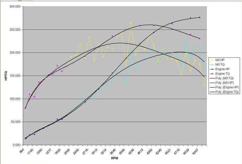

These are the specs on the 2nd car:
Tire Dia= 0.60452 meters
R&P= 1
3rd Gear= 5.3865
Mass= 1200 Kg
Yes, that makes more sense that it's just the delta that matters. I couldn't understand the absolute ms reference. So you are saying that in the following:
Time RPM
45620087 874
45620704 969
45620998 999
that the delta-T for the 2nd and 3rd datapoints is 617ms and 294ms? That's pretty low-performance sampling, eh?
As for the graphs, I'd isolate the torque and HP graphs for each situation, to help debug the problem. It's pretty easy to look at the torque and HP graphs together to see if they look reasonable or not.

Those screen shots are each of one vehicle and compare the actual BHP to the acceleration based HP. As would be expected at ~60mph a significant divergence begins. The second chart never lines up though. I think the formulas are correct and either the gear ratio is off or data from the vehicle is being interpreted wrong.
Joshua
