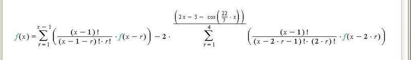

Is This possible?
Hello,
Is it possible to diffrentiate or intigrate the following equation?
f \left( x \right) =\sum _{r=1}^{x-1}{\frac { \left( x-1 \right) !\,f
\left( x-r \right) }{ \left( x-1-r \right) !\,r!}}-2\,\sum _{r=1}^{1/
2\,x-3/4-1/4\,\cos \left( {\frac {22}{7}}\,x \right) }{\frac { \left(
x-1 \right) !\,f \left( x-2\,r \right) }{ \left( x-2\,r-1 \right) !\,
\left( 2\,r \right) !}}
I'll be thankfull for your answer.
edit: I've attached the equation as jpeg.
it's not even possible to read it :biggrin:
here is the same eq. in string:
f(x) = sum((x-1)!/(x-1-r)!/r!*f(x-r),r = 1 .. x-1)-2*sum((x-1)!/(x-2*r-1)!/(2*r)!*f(x-2*r),r = 1 .. 1/2*x-3/4-1/4*cos(22/7*x))

some notes though, it's not an equation, it's a function definition. also all those factorials make it defined on some subset of the integers so you couldn't really differentiate or integrate without some jiggery-pokery

as it is no. the factorial has no derivative as it's not defined on any interval of R. i suggest you post info on motivation and context, rather than a raw expression.
How do you expect to differentiate a discreet function?
Also note the second summation upper limit is a bit suspect, it should be an integer so you should be using floor() or ceil() or round() or something there.
Additionally the use of [tex]1/2x[/tex] (again in that second sum upper limit) is a bit ambiguous. I think that strictly speaking it should mean [tex]x/2[/tex] but many people write that expression (format) when they really mean [tex]1/(2x)[/tex].
One last thing, that fraction 22/7 (in the cosine argument of the upper limit of the second sum) isn't supposed to be an "exact" rational reresentation of [tex]\pi[/tex] is it? I certainly hope not anyway.BTW. How about telling us where your goofy function comes from. That is, what does it represent?

By the way you are abseloutly correct about x/2 and 22/7 :)
you'll have to round it off to the nearest whole number for the second sum.
& thankyou for the information
Ok mubashirmansoor that second summation is making more sense now that you've explained those things.
Note that cos(Pi x) only takes the values or +/- 1 for integer x. So if x is even then x/2 is integer and -3/4 - 1/4 * cos(Pi x) is also integer. Additionally when x is odd then x/2 is half integer and -3/4 - 1/4 * cos(Pi x) is also half integer. So in all cases the upper limit is indeed integer and no rounding flooring of ceiling are required.
Now this function is looking more interesting.
Yes... You are correct, I had not looked at it from this point of view... I had checked some values in a calculator and it gave me some errors... But you are abseloutly correct.
