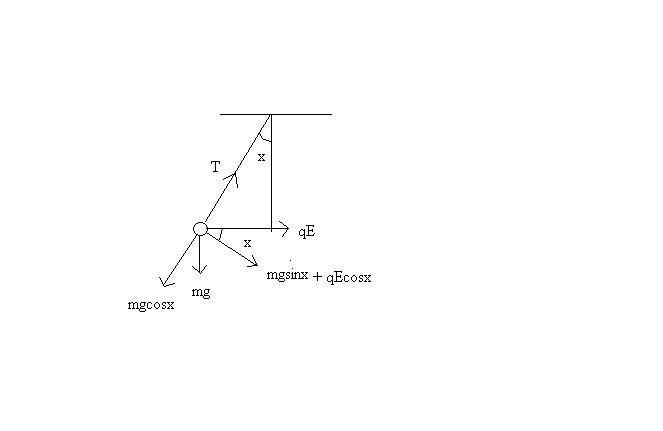

# A simple pendulum having charge q, mass m and effective length l is suspended from a rigid support between the plates of a charged capacitor whose plates are kept vertical. What is the time period of oscillation of the pendulum?
Time period = 2(pi)[l/g’]^(1/2)
I solved it in the following way:
Let x be the angular displacement at any instant. Let T be the tension in the string.
Restoring force(F) = -(mgsinx + qEcosx)
For small values of x,
F= -(mgx + qE)
But this won’t be a Simple harmonic motion. I am stuck here.
The solution as given in my book is as follows:
Tcosx = mg ---------(1)
Tsinx = qE ---------(2)
From (1) & (2),
T = [(mg)^2 + (qE)^2]^(1/2)
Effective g’= T/m
= [g^2 + (qE/m)^2]^(1/2)
= 2(pi)[l/(g^2 + (qE/m)^2)^(1/2)]^(1/2)
As per them, the direction of effective g’ is inclined to the vertical by angle x. But effective g’ should be vertical, isn’t it? Does tension contribute to the restoring force experienced by the bob?I think it is the component of weight that contributes to the restoring force? But they haven’t used that concept at all to find the time period. Please help!

The weight of an object can be determined by hanging it from a spring scale. In such a case we say that the weight of the object is equal to the tension in the spring. The "effective g" would then be the tension in the spring divided by the mass hanging from it. (The derivation of the period of a simple pendulum is done under the assumption that the pendulum swings only slightly out of the bottom position, which means that the speed of the bob will be small resulting in a negligble centripetal acceleration - the tension therefore remains virtually the same).
Forces acting are [tex]F_e=qE[/tex] and [tex]F_g=mg[/tex]. Find the net acceleration due to the two forces and that will be your effective g. Then use that term instead of g in your expression for the time period.

To find the DE for SHM, find the torque about the point of suspension due to mg (torque due to tension will be zero as its line of action passes through the point of suspension) and equate that to [tex]I\alpha[/tex] where [tex]\alpha=\frac{d^2x}{dt^2}[/tex]. Here you can use the assumption sinx=x (for small values) and you'll get your DE.
Here effective g really means the net acceleration acting on the bob. Dont think its the acceleration in the downward direction.

Yes, tension does contribute to the restoring force. Infact, tension here is the restoring force. That is why the expression for g(eff) is T/m.
F(restoring)=ma
T=F(restoring)=mg(eff)
Therefore, g(eff)=F(restoring)/m=T/m

You said that torque due to tension is zero. In that case will tension contribute to the restoring force?Isn't what you say contradictory?
Surely [tex]F_E[/tex] also has a torque contribution and should be included in the derivation of the DE!
To elaborate further on my previous point - the effective weight of an object can be defined as the force it exerts on a spring scale in a particular reference system. Therefore the effective gravitational acceleration follows from
[tex]g\prime = \frac{T}{m}[/tex]
where [tex]T[/tex] is the reading on the spring scale. The direction of the effective gravitational acceleration of the object is then in the opposite direction of the tension vector.
