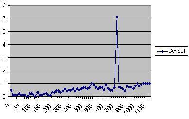

i was just wondering what the relationship between the weight and stretch length of rubber is. And also why does an 8cm rubber band increase it's stretch length by 5cm at 600gms weight while the trend before and after is every 10gm added to the weight adds 0.2 to to the lenght.

God I need help
please help me with rubber bands the graph is amount of extension v weight
I have been having trouble with this for ages

i'm back with my data

One data point off in the middle of nowhere is usually a sign of error.

Looks like you have an error (perhaps droped decmial point) should that "outlayer" be .6 rather then 6?
Looks like you have the data in Excel, you can do a linear regression to get the best fit line. I would use the data from about 200 up, as below that there is very little change.

yea, are you sure you did not mean to have that value .6??
yep incredibly sure
I have repeated the experiment a few times the jump always happens though in varying amounts.

That's true, but the critical point is at a the point of a shape change of the curve, not a transiant jump in one value. The curve remains continuous.

It seems that you are plotting the CHANGE in length. Since the basic relationship is f=-kx it would be more meaningful to plot the total length, that would change your spike to a step, much easier to understand. Also it would give physical meaning to the slope of your data.

Hmmm. I was under the impression that a uniform rubber band requires increasing force to stretch it further than its previous point. So, to suggest that a certain amount of force always increases length by a constant amount after a given stretch point makes no sense to me in my experience with rubber bands.
Indeed, does not a rubber band increase its resistance to extension the more it is pulled?
Anomalies to this might be encountered if the rubber band was not dimensionally uniform(what rubber band truly is), or if the rubber band in processing has variant elasticsity due to poor manufacturing(common; look closely at a band and one sometimes finds regions of more dense rubber), or random chemical contaminants which change local elastic properties.
Pallidin,
To the best of my knowledge you are correct, rubber bands are not very good Hooks law springs. I feel that the plot of total length vs total force would show this very clearly.
