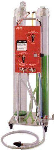

I recently had my coolant flushed at an Oil Changer shop in the bay area.
The kid hooked up a "Coolant Changer" machine to my radiator. The machine vacuum sucks the old fluid out and then pumps the new fluid back in. When he did this, he wasn't paying attention and we were both surprised by a stream of coolant coming out of my radiator similar to puting your thumb on the end of a garden hose.
According to the Manufacturer of this machine, the unit has a regulator built into keep the pressure from exceeding 7 psi. (sounds awful low) They also claim that an average coolant flush, using this machine would take only 5 min.
According to my car manufacturer, my coolant system on my car (98 subara legacy) can handle 12 psi maximum.
I have attached an image of the machine to show you the rubber cone that they use to seal the hose to the radiator. I assume that when too much pressure is appied to the system that the seal can break causing it to stream out (like what happened to me).
The reason I'm asking this is because I have a blown head gasket now. My car started over heating (which has never happened before) immediately after the flush and the splash incident (it covered my windshield)
My theory is that the machine over pressurized my coolant system causing my head gasket to blow. Either that or running it hot in the shop for over an hour could have done it (which they did that too).
Is it possible for 7 psi of water flow being pumped into an enclosed (sealed with cone) coolant system to exceed 12 psi if there isn't anywhere for the water to go?

If the machine was functioning correctly (and as you describe) then there's no way your cooling system could have been pressurised to over 12 psi without something else going on. Running the car hot is far more likely to have blown the head gasket, but if the cooling system was working properly there's no reason why this should have happened.
It's possible that your cooling system was damaged (rust, corrosion, perished gland etc) and that by clearing the system out they unlodged some goo or muck which was sealing a potential leak. Then your system was possibly run dry causing the head gasket failure?

Sorry about the second picture. These were taken from http://www.oilchangerinc.com/services/coolantservice.cfm"
If you would like to see the brochure from the manufacturers website (better pictures):
http://www.palmcrestinc.com/documents/LC2B.PDF"
and the Manual (7mb)
http://www.palmcrestinc.com/documents/LC-2Bmanual.pdf"

No way your head gasket will blow out from that machine, remember it seals the exploding exhaust gases at 100's of psi (or more?). "Blown" head gaskets are actually a misnomer; when the head overheats due to loss of coolant, it warps and the gasket is no longer compressed, giving you a leak.
Perhaps you can explain your comment that they "ran it hot in the shop for over an hour"? Was the car idling the whole time?
Also describe the radiator leak. Was it properly repaired by a radiator shop?
Without more information than you've given so far, I'll describe the following possible scenario:
Your radiator sprang a leak under the pressure of the flush operation. Either your radiator was rotten and ready to let loose anyway, or the machine operated at high overpressure (if the latter, why wouldn't the cork have popped out?). The attendant refilled your car with coolant, you drove away, it all dribbled out (maybe when it got hot?), and your head overheated. Or maybe he failed to fill your car, you drove away and overheated.
In any case, I wonder if your car had some coolant system issue to start with (as Brewnog also asked). Sorry, I know that's not what you want to hear...

That machine smoked my car! the guy didn't turn off the air pressure(70psi) before he refilled the radiator! He over pressurized it until it popped a head gasket. It MIGHT have been weak and ready to go but would have lasted another 50,000 miles easy if the guy would have been paying attention...My car started overheating immediately, spiking to the top and droping back down...they flushed it three times and sent someone to the store to buy a replacement thermostat...no cost...I asked them if I should turn off my car...they said your car isn't really hot, it's just the gauge telling you that because your thermostat is broken...ok...1.5 hrs later they get the car to hold a temperature. I ask for some money back...they give me 20 bucks...I leave...1 month later it spikes to the top and drops back down...go figure..

I still don't see how the machine could provide enough pressure to damage your head gasket. The overheating (more correctly 'undercooling') is the probabe cause; you said yourself that the coolant pissed out. What caused the leak we don't know!
I wasn't saying it's possible your head gasket was weak and ready to go, I was saying your cooling system might have been weak and ready to go. Without coolant, your head gasket wouldn't have lasted very long at all.

Glad that you won, sky1tech. However, I'm still sure that the pressure from the machine itself didn't blow your head gasket. There are probably 30 or so connections and components in your cooling system that would have failed due to high pressure before your head gasket did. As marcusl rightly pointed out, combustion pressures are hundreds of times higher than the pressure any flushing machine could develop.
30 or so connections?
Top and bottom radiator hose, two expansion tank hoses, two heater hoses.
Then there are the radiator and heater themselves, filler cap, drain tap, water pump, thermostat, temperature sensors, etc.
And the head gasket... :rolleyes:
Thats about 15 components and a similar number of seals clips and gaskets, without trying too hard.
Yeah, hose clips either side of the radiator, hose clip on the thermostat housing, expansion tank, all the bosses and tappings for the sensors... Aleph's got it!

They did finally change the thermostat after 3 flushes, so I suppose the geyser could have done a number on the thermostat and the overheating in the process blew the head gasket. Remember, I'm not a very mechanical, mechanical person. I just throw out what makes sense to me.
