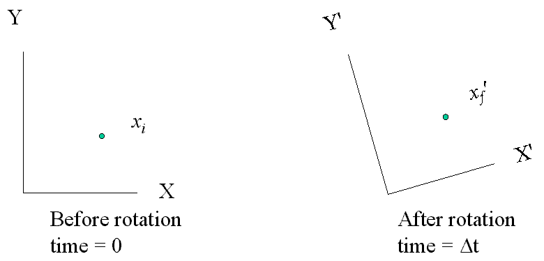

The point x is rotating in the same way as the frame.
In a small time interval the frame rotates from the XYZ to X'Y'Z' axes. The point also rotates from x_i to x_f.
You can describe the position of x_i and x_f in both the XYZ and the X'Y'Z' frames.
Because the point and the frame rotate the same way, the coordinates of the point in the intial frame before rotation are the same three numbers as the coordinates in the rotated frame after rotation. That's not the same as saying the point doesn't move.
Maybe a picture in two dimensions is easier to understand. And keep in mind that the pictures are all drawn as seen by an observer "fixed in space" and "not rotating" (whatever those two statements mean!)
Then why would the author relate the initial point [tex]\{x_i\}[/tex], in the XYZ axis, to a point [tex]\{x'_i\}[/tex], in the X'Y'Z' axis before a change in time delta{t}, where the axis makes a small rotation? This is what does not make sense.

Because you already know how to transform between two different coordinate systems that are defined at the same instant in time, and you know how to rotate a point in a fixed coordinate system. He's building on those two things to define "angular velocity".
If you like, imagine the process happens in two steps: first you rotate the point with the coordinate system fixed, then you rotate the coordinate system by the same amount. Or, you can rotate the coordinate system first, then rotate the point.

Ok, now your picture has been approved.
Observe your picture. I get what your saying. That is xi and xf.
But that is not what the book is saying. The book has an xi and an xf and and x'i and an x'f in the same frame (Both relative and inertial).
You, on the other hand, have one point in each of the two frames. I.e. you ONLY have one xi and ONE x'f.
One point in EACH respective frame.
See what I am saying?

As I read it, the book has only one point x that rotates.
You can decribe its position before rotation in two ways:
xi in the frame before the frame rotates, and x'i after the frame has rotated
You can also describe its position after rotation in two ways:
xf in the frame before the frame rotates, and x'f after the frame has rotated.
And since the frame and the point are rotating in the same way, the coordinates of xi are the same as the coordinates of x'f.
That's what 2.5.5 is saying IMO. If that doesn't help, sorry, I don't know how else to explain it.
