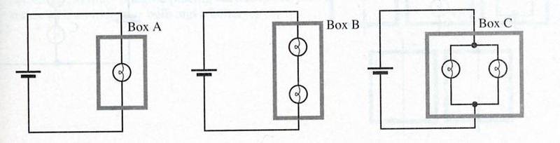

Okay, I am really confused about parallel and series and their differences. I know how they are set up, but I do not know how their arrangements may change the circuit may result in a change in total resistance. From my lab, I know that connecting the light bulbs in series will make the light less bright than it is by itself and connecting in parallel won't change the brightness at all!
My questions are: (and I will put my thoughts into the questions)
1. How would the different arrangement (series and parallel) affect the total resistance of the circuit? From the result of my lab, I think that there is going to be more resistance in series than parallel
2. In a two bulb series circuit, how does the current through the battery in a single-bulb circuit compares to the current through a battery in a two-bulb series? Current through the battery in a single-bulb circuit is going to be more than a two-bulb series circuit
3. How does the amount of current through a battery connected to a single bulb compare to the current through a battery connected to a two-bulb parallel circuit? The two bulb parallel is going to have more amount of current going through the battery
4. Would the total resistance of a circuit increase as the number of parallel branches is increased or decreased? No.
5. Does the amount of current through a battery seem to depend on the number of bulbs in the circuit and how they are connected? For parallel, current through a battery increases compared to a single bulb circuit. For series, current through a battery decreases compared to a single bulb circuit
6. In the first picture below, rank the networks A-C according to their resistance? B>C=A

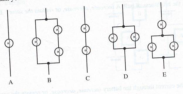

7. In the second picture below, rank the networks below according to resistance? C=E>B>D=A

1) Yes, you verified this experimentally.
2) Assuming the resistance values are all equal, then yes, more current will flow through the single bulb circuit than the two bulb circuit. Ohm's law shows this pretty easily.
3) You got this one right too. Circuit reduction would show that the parallel bulb resistance will equal half of the one bulb circuit.
4) Why do you say no? I am not going to say whether it is right or wrong because it doesn't seem like you put much thought into it. What is the equivalent resistance of two equal resistors in parallel, and what about four?
5) Okay, so you have this right. Is this because you verified it experimentally or know the theory?
6) I think you want to review the equivalent resistance for resistors in parallel.
7) I am not sure why you think that resistors in parallel would not have an effect on the overall resistance. Remember in your experiment how the bulbs in parallel had more current flowing through the battery than the single bulb, could that happen if the total resistance was the same?
