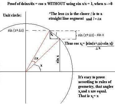

It is possible (and easy) to prove dsinx/dx = cosx WITHOUT using limit lim sinx/x=0. A have made a picture to show it (it goes using geometry) but I don't know how to show it here.
Oh yeah, I learned how to attach:) So here is the prove that doesn't use the fact sinx/x-->1 when x--> 0 nor (cosx-1)/x-->0, when x-->0. (if i did the attach properly)

You can't just say that the less delta-x is, the closer l is to a straight line. (It is true, but not established.) In order to show that, you need to know sinx/x --> 1.
Edit: I had need not know. Changed to need to know.
ups
Yea, true, I didn't see it. But from the picture above you can see, that
xcosx < sinx < x, which implies, that cosx < sinx/x < 1 and taking limits we see: lim_x-->0 cos x <= lim_x-->0 sinx/x <= 1, hence lim x-->0 sinx/x = 0.
The first inequality xcosx < sinx follows from the fact that the area of the sector OCD (xcosxcosx/2) is smaller than area of the triangle OCB (cosxsinx/2). cosx <> 0. That is xcosxcosx/2 < cosxsinx/2 <=> xcosx < sinx. And sinx < x we get the same way.

? This shows that lim_x-->0 sinx/x= 1, not 0.
ahh.. yes, my point was to show, that it is 1. Writing 0 was just a mistake . Sorry.
