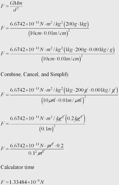

Why, in the second step of the question, is 0.001 added to the right side?
200 is multiplied by 0.001 to convert it from grams into kilograms, since there are 1000g in 1kg-- does that answer your question?

You just need to check that the units cancel to give a unit of velocity (noting that N=kg m s-2), then compute the numerical answer.
So would the next step be: Ve = sqrt 2(6.6742 x 10^-11 kg m/s^2 m^2/kg^2 (12.1kg)/0.106780959m ?
If not, then what?
Yes, now check that the units cancel and compute the numerical answer.
Personally, I think the method of keeping the units in during the calculation is very confusing, and that you should convert everything into SI units before plugging into the equation. But ,if that's how you've been taught to answer the question, then I guess you should do it that way.
