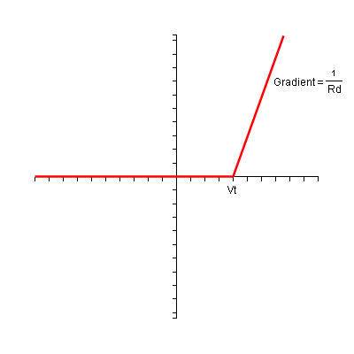

can someone advice me on how the graph should look like for a circuit with diodes connected in series?
Can we model the diodes this way?
Attached picture shows the graphed charecteristic for 1 diode.
If its for 3 diodes, how should the graph look like?
Am i right to say that Vt will be 3 x 0.7v (Assuming the diode voltage drop is 0.7v) and value of Rd will be (3 x Rd) to model the resistance of the 3 diodes connected in series?

Vt is right, and the gradient probably is as well.
As you put more elements in series you would expect the current to go down (gradient decrease, here you reduce it by 1/3 which makes sense).
However, I also suspect this model will loose accuracy pretty quickly as Vt increases.

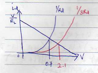

I've posted another attachment of a sketch by hand of the new graph.
Please advice thanks.

Hmm, I'm not really a device guy, but I'll try to answer this. First, your revised curve looks right (although not drawn to scale...). The slope (tangent) to your curves where they cross the load line is the inverse dynamic resistance 1/Rd at your value of DC bias.
